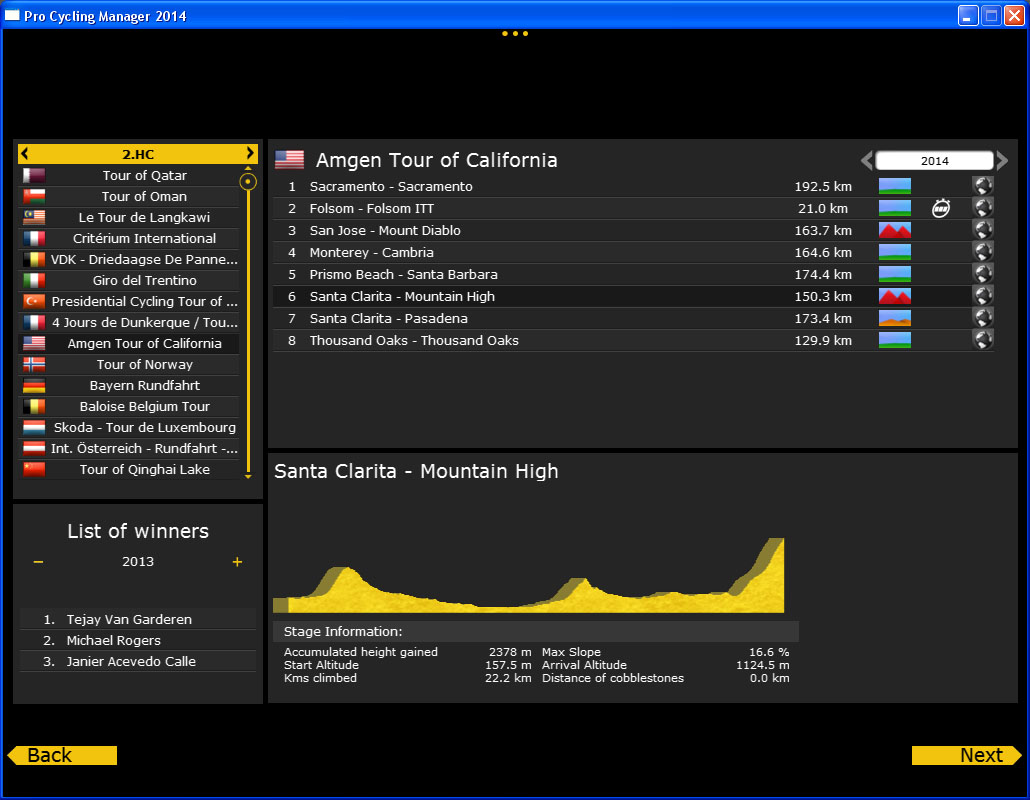

| clamel |
Posted on 14-08-2014 08:22
Protected Rider
Posts: 1359
Joined: 13-07-2010
Cossack wrote:
In DB Ventoso has 77/76 SP/AC while Lobato has 75/75. I'm sure that it should be the opposite, so switched it.
Two more notes on variants (can't give the variant names now, can check in the evening):
1. Etole de Besseges finishes with 2 TTs looking almost the same
2. Tour of California has two different stages finishing on Mount Diablo, I'm sure one of them should finish on another mountain.
I got some strange stuff too on Tour of California
BUT mates I got the solution..
Look in your CM_stages folders and that´s the answer.
Make a search on *Calif*2014*
getting all the files using the important sequence of t0_california_2014.xxx
There should be 2 files on each stage BUT in my folder I managed to have 3 file on stages 6,7,8.
(That stage 7 being that double Mount Diablo.)
Now that third file cdx-file (one for each 6,7,8)is pointing to the three
t0_california_06fs_2014
t0_california_07fs_2014
t0_california_08fs_2014
HOWEVER in the folder are already three 1-year old files
t0_california_06_2014.cds
t0_california_07_2014.cds
t0_california_08_2014.cds
and of course same named zces-files
These are actually the three last stages of 2013 !!!!
so rename these 6 files.
The files ending with .zces and .cds
You should keep the -cdx-files and the files with that _fs_ (which are the correct three stages for 2014)
Now you got that second mountain stage ending up on correct Mountain High
Hope you got that VERY confusing explaining.
But some renaming will do the trick (Nothing with this great DB)
Be careful
Not sure how to get an image on this. But I try again later.
Guess I got to upload the image somewhere ???
