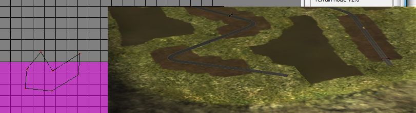

Ive been trying to make a few criterium races using the stage editor but every single time I have the same problem.
When drawing the roads, it doesnt matter how close they are to each other or how far away they are, when the stage is rendered the roads never join up.
SportingNonsense attached the following image:

Have you tried laying down some roads yet? Also what does the code look like? Not that you'd have made this mistake, but, is there a minimum of 3 circuit loops in the code?

SportingNonsense
How dya mean by laying down roads - isnt that what Ive already done?
And yes, there are more than 3 loops of the circuit

NO, you have to give the roads a type, national, departmentale etc. If you haven't done that, you get this problem. I post here a link of one of my criterium stages and you can see how it works

By laying down roads I mean actually putting the roads in. All you've done so far is put in some waypoints - the route the race will take. Now you need to fill over the course with roads. 2 Roads are probably best. Start a road before the first waypoint, then click on the waypoint, and then the last waypoint that the road will go to. Click yes on the pop up (if there is one) and then click outside the circuit to let the road go somewhere. Start another road (best to select a different tool, then go back to the road one) and click on the last waypoint you finished the other road off on. Then click again on the last point you want that road to run to, and finish off by clicking outside the circuit again to let the road go somewhere.

Thanks to rjc explaining it in a bit of detail, and the stages jaap uploaded, I now understand how to do it Smile
