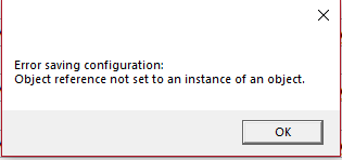

1. It doesn't seem to work other than on PCM17. When I try to set the default directory to PCM 15 I get the error in the attached picture. It seems like it should work as you said, so maybe I am doing something wrong or there is an easy fix.

Ulrich Ulriksen attached the following image:

- Yes, I don't have 2015 version installed and it might not work for others. However, the program simply looks for those *.png/jpg files present in the selected directory and fills the Listbox in the middle to show what's available.
- Besides that, it looks for the CM_Stages directory in the default (2017) directory (although that woud be very easy to fix).
- It recognizes those CDX files that are located in any directory pending from the User Directory, but it checks that the corresponding CDS files already exist. That would be an easy fix as well.
