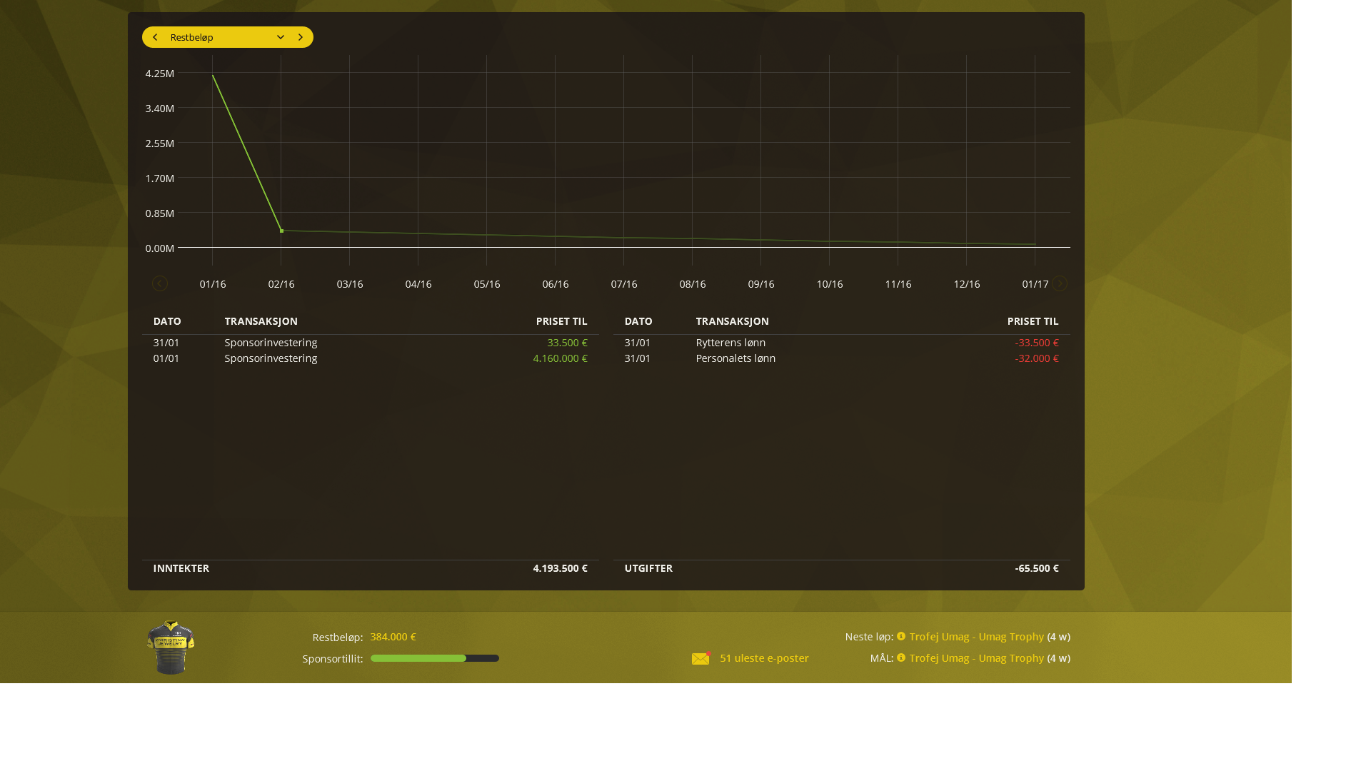

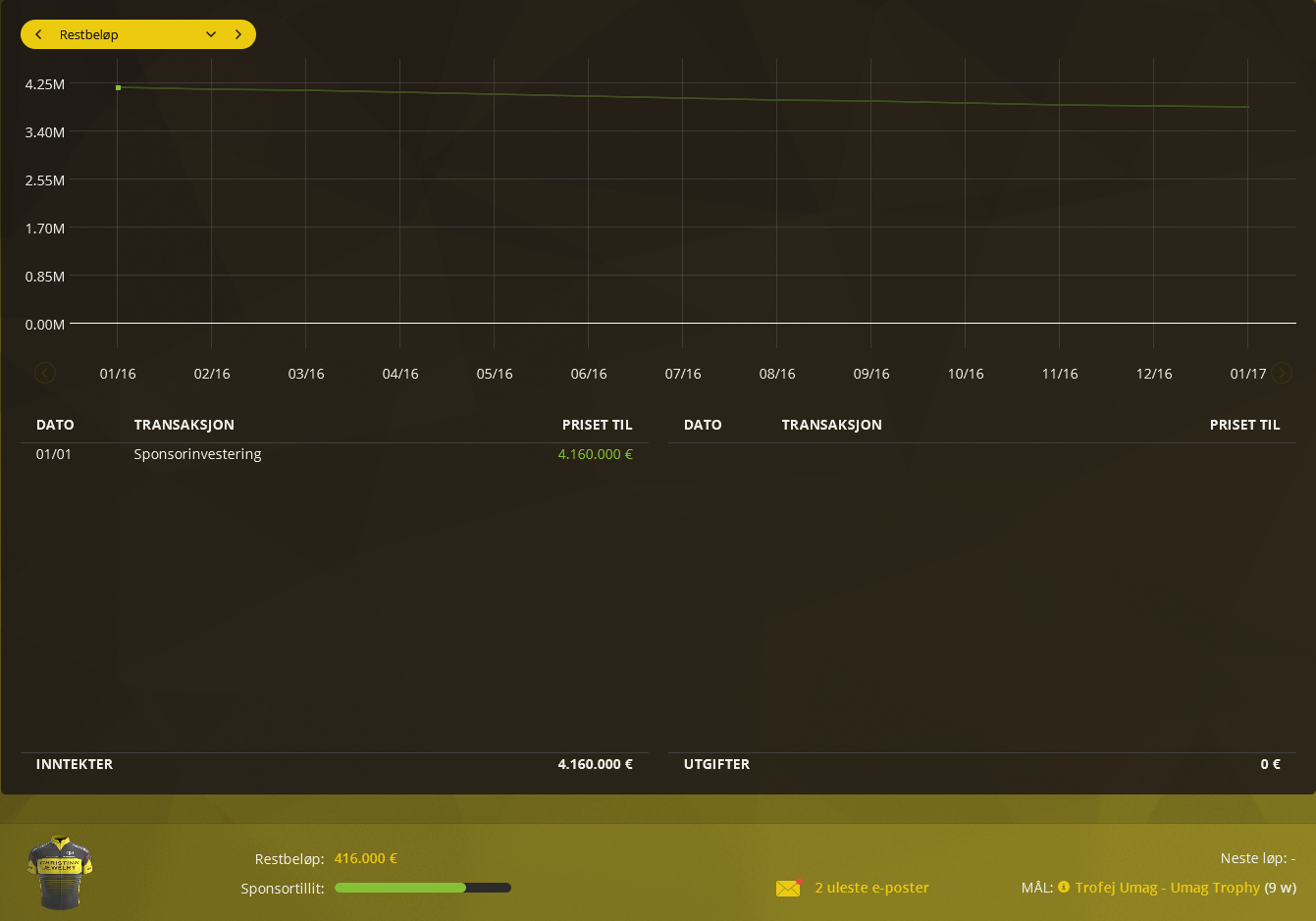

I tried what you told me on a saved game now.
This is what I ended up with
First pic season day one.
And number two day one of february. I got 4million, but still ending up in minus because I only got 400 that im alloved to use

GAM_career_data > SOLDE
| Zinnie |
Posted on 20-07-2016 12:09
Junior Rider
Posts: 44
Joined: 04-08-2009
Thanks, your a GOD  |
