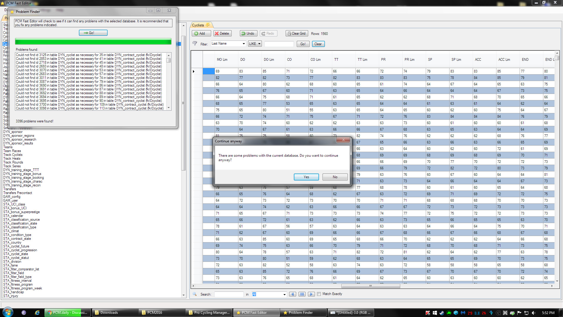

I've used the PCM Fast Editor on both PCM 2015 and 2016 now, both using Pro Cyclist Mode, and I get a message about missing information when trying to save the DB. It didn't seem to create any problems, i was able to play to lvl 26 in 2015 without any ill effects (at least to my knowledge).
Is this normal or related to Pro Cyclist mode in some way, I haven't used it for Career mode. The size of the original DB (the save db made when you start a new pro cyclist save) is a fair bit smaller after saving with Fast Editor.
Initially I thought the error was related to using it in 2015, but now I see it doing the same thing in 2016, so curious.
Thanks

Can you take a screen of the exact message appearing?

Seems to related to the clean up tool. I don't know if I enabled that option or not.
Here is the screen

One note - if clean up is turned off it doesn't give the error, but the size of the db goes from 387k to 323k regardless.

That's not an error but a notfication.
According to that picture there are contracts in your save which don't belong to any rider.
The fast editor suggests to delete those and if you don't have any problems in your Pro career, then I would accept it.

Thanks Lachi,
I guess error was a strong word, message was more appropriate. I was just wondering if it was a normal thing or not.. I've had no problems that I know of from editing my saves with it so far.
