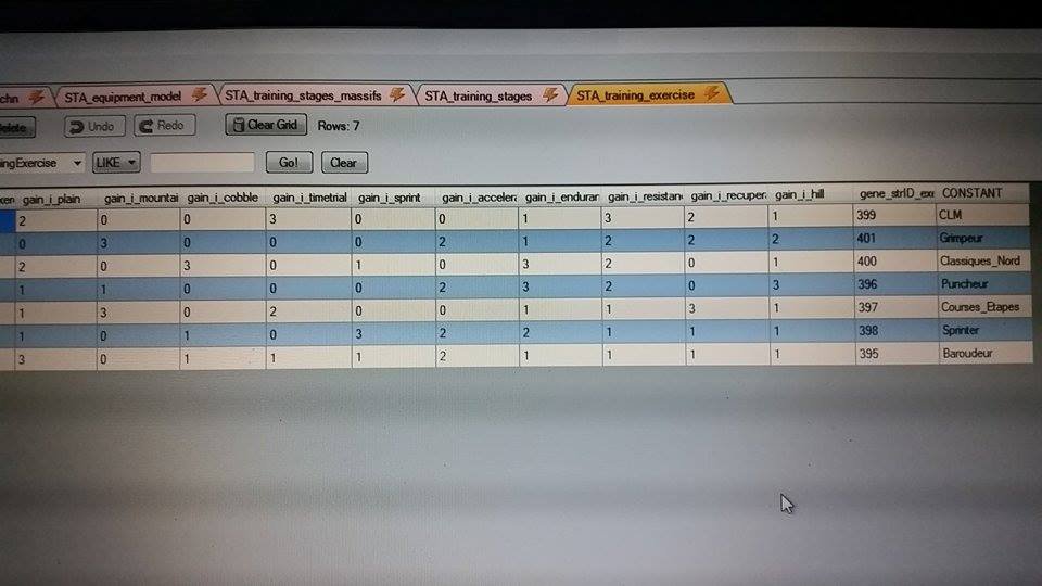

Im posting a photo about the trainings and how they influence your stats.

Pieroku attached the following image:
