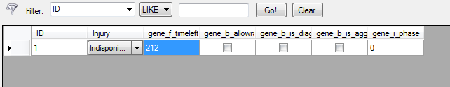

I'm doing my own db and a I have a question with Dyn_injury.
How does gene_f_timeleft column work? I have to write real days? because for Ewan's injury on Original Realease db the value is 273 for the middle of june but if you count the days in a calendar it is 166 +-... so... tell me please =)

It can't be real days because, i've created a new injury wich will start at 1/1/2015 (d/m/y) and will end 1/8/2015 so, 31+28+31+30+31+30+31=212 (J+F+M+A+M+J+J)
If I write this number at the column, save the db and go to the game, in game, the injury ends at may (you can see is may because there is a pink bar, giro's bar).
i.gyazo.com/badaef1b2aa6f668b0927cd9da206681.png
i.gyazo.com/f03410388e0dd2cfd40a504a1538750b.png

Looks like you're right, but I'm sure it has changed between PCM 11 and 14 because I'm 100% sure that it was so back then. Looking into a savegame dyn_injury table, that's what I got:
i.imgur.com/qAfJTBo.png
It's weird to have some decimals. So I opened pcm 14 and looked into that save, turns out that...
i.imgur.com/SpZvxKr.png
...well the system is totally different. If you can't translate italian, it shows that the date is January 2016 and the worst injury will end at the start of March 2016. So that 439 number definitely means something else. I've done a quick research on the internet but looks like that it was as I said, meaning that the system has definitely changed and I remember correctly. Sorry, can't really tell, perhaps someone else's got a proper answer Frown
