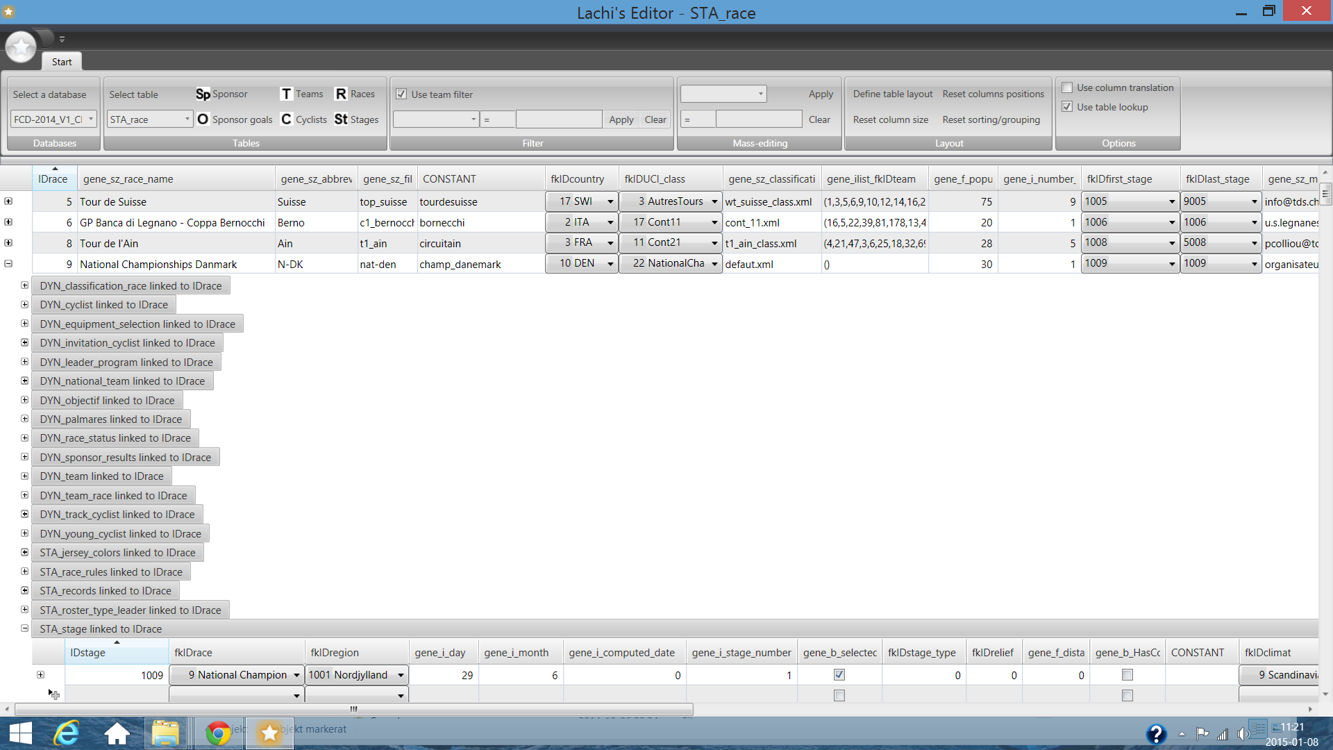

As far as I understand about jerseys the national jersey is only put on in the World Championship, but then during normal race dates the team has to have a jersey in that folder.
named something like tcs_maillot_den for the danish champion riding for Tinkoff.
That jersey is found in the folder cloth/team/tcs
Adding Japan to ride in the World you have to replace one of the 26 other nations in the table STA_nationals and then fix connections for Japan in the STA_country table.
A picture says more than thousand words perhaps ....
Then the only thing of importance outside this picture is the field fkIDtype_tour in the STA_race, that informs about the type of race. In this case one the CLAS_ selections (CLAS_TTT in case of the national time trial race)
clamel attached the following image:
Edited by clamel on 08-01-2015 10:28
