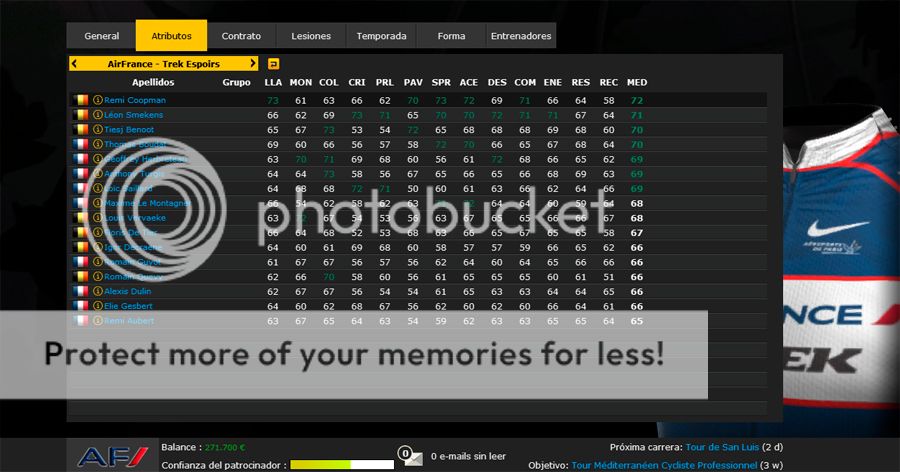

I'm playing with a custom team, with riders under 23 years old and stats not above from 73/72, i play in hard difficult.
And i already won some races and got several top 3, 5 and 10 in stage races or in some classics. My sponsor is very happy (full green bar) and i earn important money to keep my custom and young team in race.
So, in my opinion isn't hard to play with this kind of teams.

I forgot to post an image from my team:
i767.photobucket.com/albums/xx319/canojuancho/aft_plantilla2014.jpg
And the sponsors objectives:
i767.photobucket.com/albums/xx319/canojuancho/aft_objetivos2014.jpg
