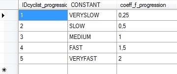

Well, I think the conern may come from STA_cyclist_progression.
I suppose values are directly related to training progression and as you can see, lowest value is 0,25 and highest value is 2 (8 times the minimal values).
I decided to increase some low values in my database but did not test it yet.
sylvao attached the following image:
