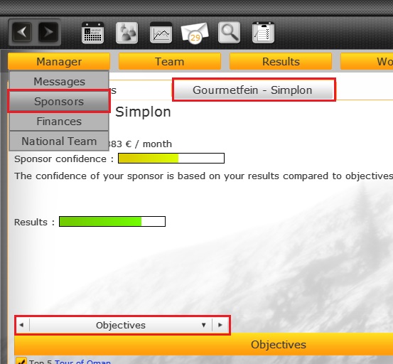

This is way to less information to find the problem.
When exactly does it crash? Where do you click? (see image below)
Did you edit your save at any time? If yes, what?
Was the sponsor contract running out? If yes, when?

the crash occurs when clicking the sponsor tab from the manager drop down menu. I never get to view the actual sponsor page to see what the seasons objectives are.
I have not edited any portion of the game.
It is currently Jan 2nd 2015 and my sponsor contract isn't due to expire until 2017.
