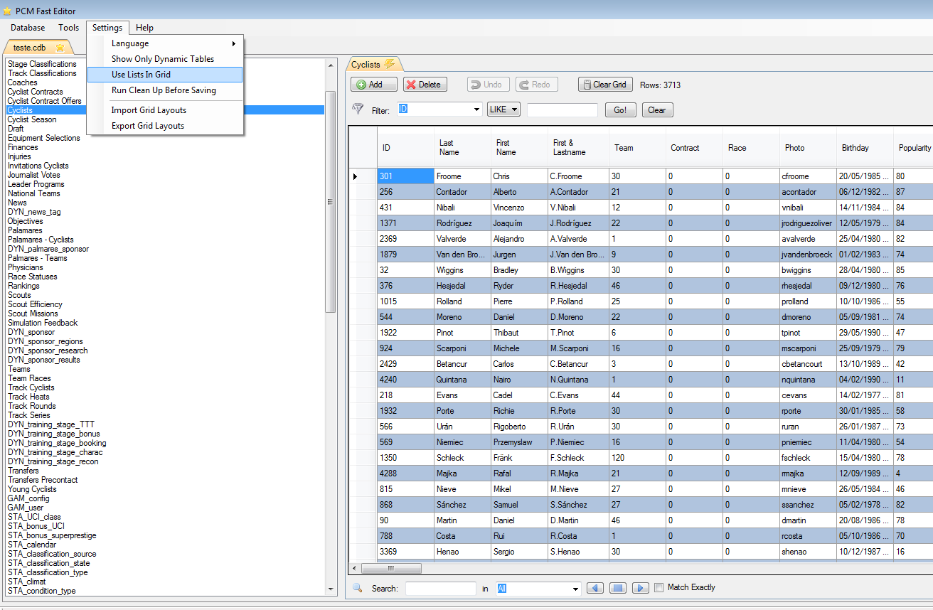

Where can i do that? Can't find it anywhere. |
| Dippofix |
Posted on 21-07-2013 14:41
Grand Tour Specialist
Posts: 4126
Joined: 29-01-2013
PCM$: 300.00
Does Nobody know?
| lluuiiggii |
Posted on 21-07-2013 18:40
Posts: 8425
Joined: 30-07-2010
Here:
| Dippofix |
Posted on 22-07-2013 12:00
Posts: 4126
Joined: 29-01-2013
PCM$: 300.00
Thanks, it works perfectly now! It was actually right there in front of my nose Thanks for the help, i really appreciate it!
