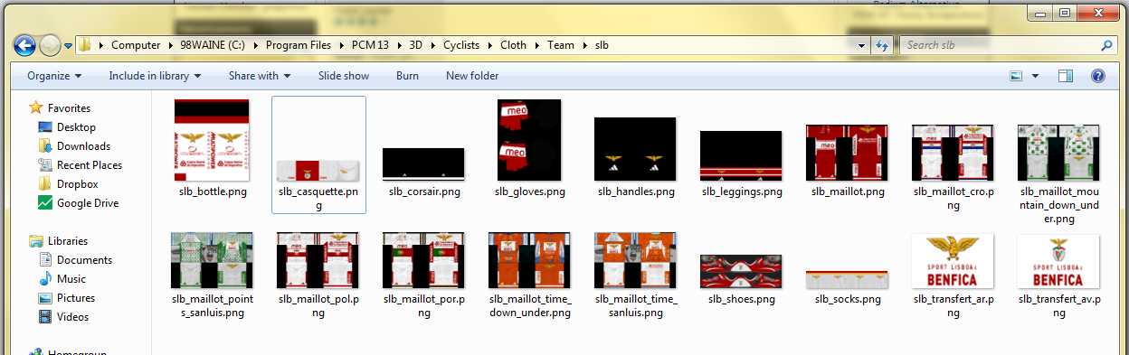

Hm, that's weird... can you post a screen of the files?
cj2002
Like this you mean?
It's strange, because I have no problems with the other graphics - all the NC jerseys are fine.
cj2002 attached the following image:
lluuiiggii
Everything looks fine, it's strange indeed... the shirt is in the correct size, right? Maybe you can upload it here so we can test it?
