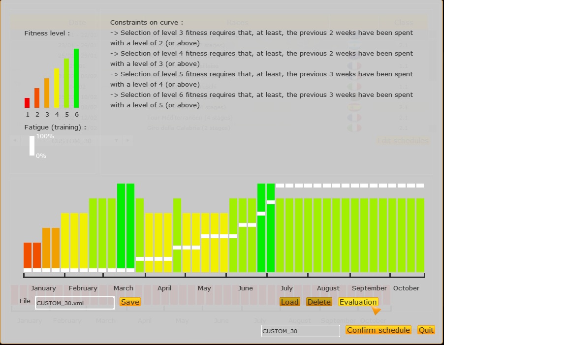

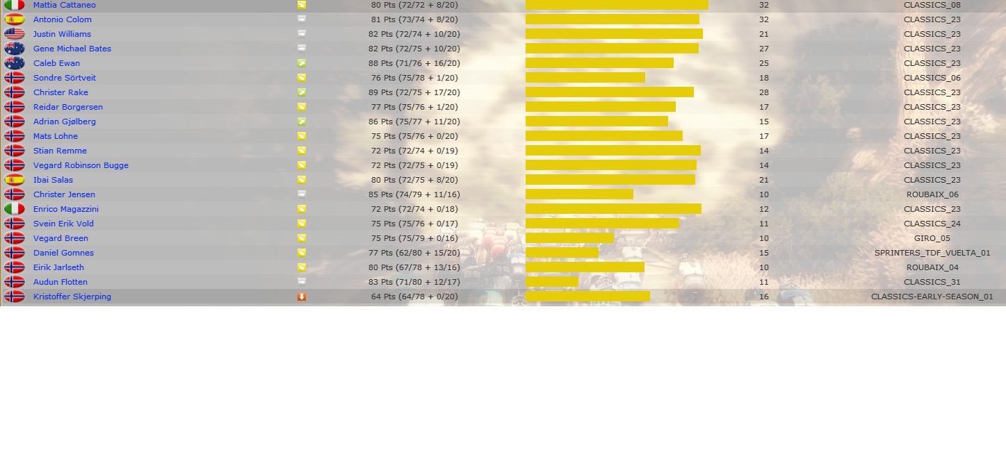

About 5 months into my first serious game in PCM12, I noticed the max fitness from training had decreased on pretty much all my riders(at lest the decent ones...).
I set many up with the classics_23 fitness chedule, as it seemed to give good form early and over a long period. Now I see that was maybe not so smart, as the max fitness has decreased quite a bit. See attached pic.
Questions:
1) Is there a way to know what fitness level a rider has or can one just look at the points (training+race)? In Cym04 there was 7 fitness levels ranging from very bad up to excellent.
2) Is there a way to know how much fattigue a certain fitness tr. schedule will give? I assume there is an account you fill and the bars represent a specific value for each type in the fitness schedule. When the account is full, you start to reduce the max 80.
3) What purpose does the recovery training camp serve? I looked at the result and there were just a 4 digit number next to each rider. No-one seemed to gain higher max-fitness in the training, it actuelly went down a point or two...
If you know the answer of one or more questions, please help me out.
This game is very different from Cym4, and my experience there seemes like it is worth nothing :-)

1) You just take the addition and then you have the fitness. x/100. Everything less than 70 is not very good and maximum in the early and late season good enough for solid results. For the peaks like GTs, Ardennes etc you should have ~90+
2) When opening the training schedule to edit it there is an option for fatigue. I dislike the Cyanide schedules as they are too much imo. I make my own plan for every single rider with Lachi`s Season Planer.

I took a look in the custom fitness sch. and there is as you say a calculation there. See attached pic. Is it when the white steps starts you actually loose some of the original max 80 points fitness from training? Anyone know how many points does one step mean?
Still would like some info about the recouperation training camps.

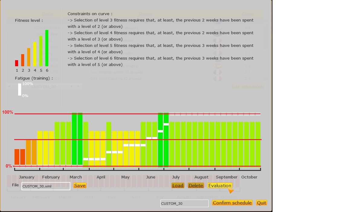

He asked when the 80 fitness points start to decrease. 80 fitness points = training fitness.
Luigi's answer is correct but you cannot get much from it when you do not know how these numbers translate to the fatigue bar in the game or the fatigue evaluation in the fitness schedule. But taking into consideration that eple mentioned 50% and that the legend and scale for the white bar is mentioned on the picture, it should become obvious.
Description of the attached picture:
Colored bars = training fitness
White dotted line = fatigue
Red lines by me = Scale
Edited by Lachi on 11-02-2013 22:57

Well, ignoring some of the posts in this thread but answering to Lachi and to complement my previous answer:
I copied the attached plan to the Fitness Planner. According to it, fatigue should start affecting your max. training fitness form on the 1st week (level 5) after the 1st lvl 6 peak of 2 weeks. Therefore, what the game calls fatigue 0% doesn't mean no fatigue, but means no effect on max training fitness.
However this (decrease of max training fitness) will only become a big worry on the last week (level 5) before the 2nd lvl 6 peak - at that point, fatigue is 8.000 and max training fitness is 75 (therefore game's 50% fatigue = 8.000 fatigue points/75 max training fitness), not much, but from here on, it'll go down very quickly, as shown in the game. By the end of the 2 following weeks (both in level 6), fatigue will have reached 10.000 which drops to a max 65 training fitness (what the game shows as 100% fatigue).
So it's not a linear progression, which is another reason for me to recommend you to use the Fitness Planner. It gives much more precise values of the expected fitness and fatigue than the game does, so I find it much more useful
