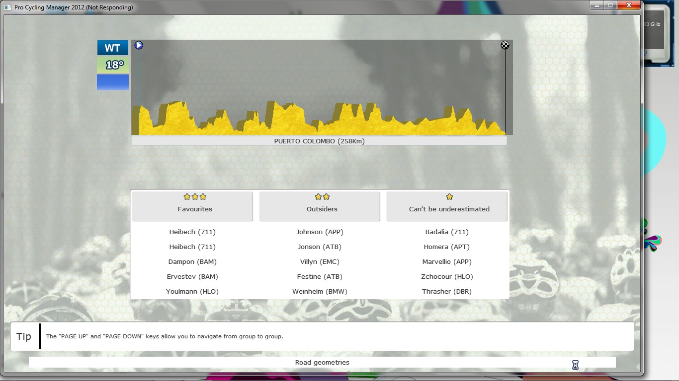

I have recently made a fantasy stage in the Canary Islands. I got everything in order, then added to DB, so on and so on. I tried to open in PCM 12, and my game froze as soon as I got to loading "Road Geometries". How can I fix this issue? Thanks! |

Perhaps this will help?

In 2 hours, I don't think so. Also the screen doesn't really help, what could help is the last lines of the log file after the crash.

Reviewed this in Stage Editor, and the city thing spawned a fountain in the road? Maybe that caused problem. And lluuiiggii, the title is a bit misleading; the "crash" is not the game auto-closing, it just freezes and stays on the above screen for hours and hours, so there is no log. Sorry. |

Well, the log is "created" while the game's running, so there probably is one Unfortunately I don't know what could it be, but a graphical problem (such as a fountain in the road) would highly unlikely be it. Try opening the stage with the Stage Viewer, does it work?

No, it does not open in Stage Viewer... |

Then there's a problem with the stage. If it still opens in the Editor, try re-exporting and see if it works; if not, then an option would be to export the stage roads and try re-doing the rest of the stage.

IDK what it is, I did actually re-export, so I guess I'm rebuilding... |

But did the re-export work in the game?

No, I did rebuild, however, and so far it works, but it can't run smoothly in Shader 2.0. |

If it works in 3D but it lags, it could perhaps have too much graphics, especially water which is perhaps the thing that make the game lag the most.

Especially, since I covered 90% of the world with water... |
