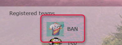

I now have more weirdnesses. I went back to start over, one step at a time, using the Excel editor (faster - thanks). I have a single team and sponsor added and a few riders and am testing and it doesn't crash but the graphics are either missing (main shirt defaults to the Cyanide shirt) or the minimaillot is somehow corrupt.
jersey_sz_abbreviation does point to the directory in 3D/Cyclists/Cloth/Team/xxx, yes? So if the jersey_sz_abbreviation is ban and the directory at that location is ban with the file ban_maillot.tga, doesn't that seem correct?
As for the minimaillot, I've never had such problems before. See the screen cap below. Something up with the transparency? Does PCM 2011 support TGA files for minimaillots or do I need to go through the whole DDS process?

9-Ball
Ugh - disregard the last post. I figured out the shirt issue and the minimaillot files had messed up alpha channels. Fixing now. Rolling Eyes

Some idiot (I've no idea who now Rolling Eyes ) had misnamed the main 3d shirts so that instead of ban_maillot.tga it was banesto_maillot.tga.
As for the minishirt, it seems the alpha layer was mangled so I have to refinish all my minishirts and logos. No big deal.
