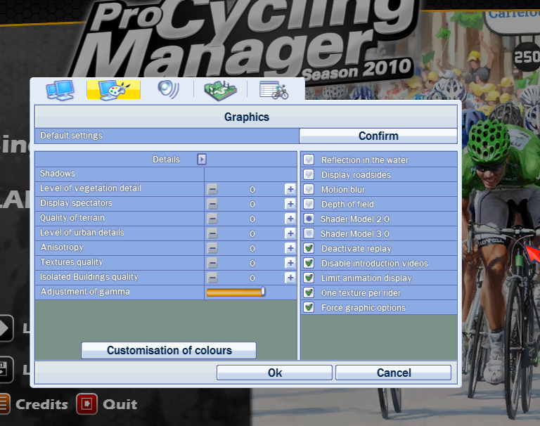

When lowering the settings, did you check Force graphic options? And uncheck stuff like replays, one texture per rider etc.?

Yes, the settings are as far as I can see, as low as they can get. Check the attached image. Also when I monitor RAM usage it goes from 750MB at the start of the stage to around 780MB at the end when it stops.

gunde99 attached the following image:

No, one texture per rider uses much RAM.
As it says, one texture per rider is used instead of on texture per team.
10 riders per team. This must be a problem.
