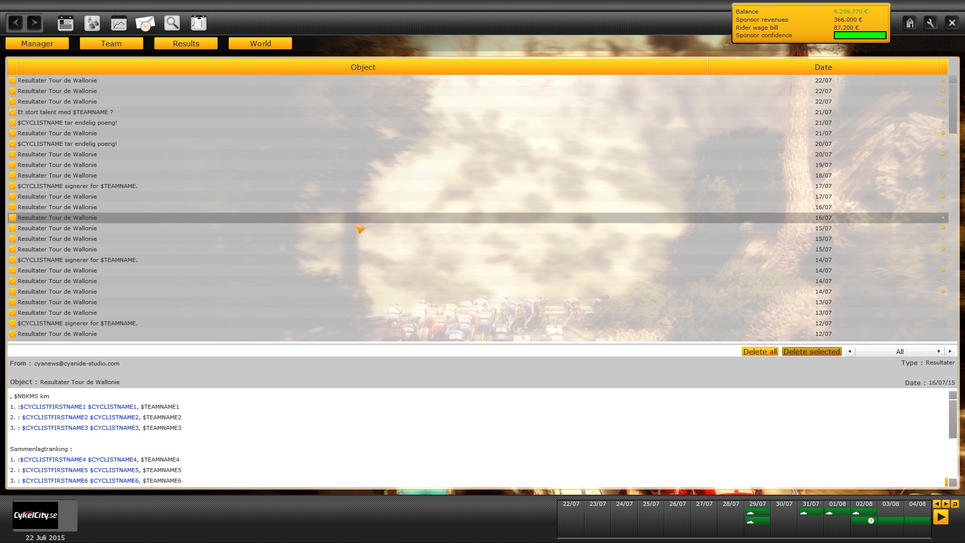

After I used the newest Lanchi editor this happend to me.
Not right after but a few more months in the game, and I am in the third sesong
Bolsen attached the following image:

Could you upload the file so that I can look into it.
Could you also please verify if it really caused by your editing/my editor:
- Load the unedited save*
- Continue in your career by doing the same things you did before
* In case you don't have it any more, copy the file from the weeklysave folder, which is close before you did the edit.

Could it be that you edited the local.cdb file and not your save file?
Or did you install another DB? |

I use RSM-news DB 2012 v0.5 |

Did you install another DB shortly before that problem occurred?
Did you install a patch shortly before that problem occurred?
Did you try if the problem really comes from your editing? |

No only used that DB since the game was installed.
Last patch I got I think is only for multiplayer?
I went back on the weeklysaves from when I used your editor and the same problems accures around 1/7 |

It is not easy to understand you.
If you installed the patch after you installed the database, then this could have caused the problem.
The easiest way would be to install the database again.
BTW:
It is generally not wise toplay with an outdated DB. So just get the latest version of that DB which is compatible with patch 1.1.0.3.
This is how you have to install a DB:
- Game
- Patch
- DB
If you do anything differently, then you are only waiting for problems.

Well I installed that DB when It came out, and the game has been patched after that as far as I know.
But il try what you say. Make a new save |

Like I said, it is hard to understand you. Why do you want to make a new save, I never said to do so.
If you don't install the latest version of that DB, then you will see the same problem even if you start a new career.
But if you install the DB correctly, you should be able continue your career.

Came out wrong from me there.
I never new the DB had to be up to date with the patches.
Sorry for the misunderstandings |
