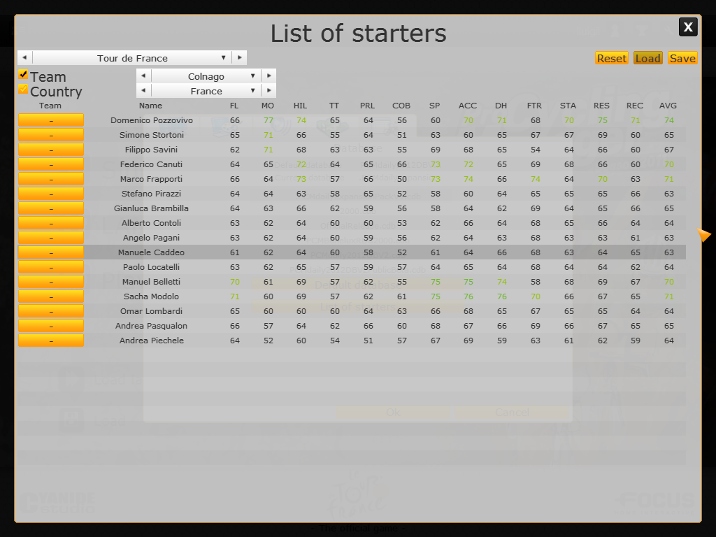

| lluuiiggii |
Posted on 26-06-2012 17:30
Posts: 8425
Joined: 30-07-2010
petz_e wrote:
I did try the inbuilt startlist editor, but this one does not list the rider per team. It just simply presents a list with ALL riders (no matter what team you have selected). This whole process is very tedious, and I gave up.
Not related to SN's point, but can't you check the team filter to show only riders from the team like in PCM11 (see screen)?

lluuiiggii wrote:Not related to SN's point, but can't you check the team filter to show only riders from the team like in PCM11 (see screen)?
That's how it is supposed to work? In PCM12 the list shows all riders no matter what team you select in the drop-down list

| lluuiiggii |
Posted on 26-06-2012 21:56
Posts: 8425
Joined: 30-07-2010
Can you post a screen of the PCM12 startlist tool?
| petz_e |
Posted on 26-06-2012 22:35
Under 23
Posts: 57
Joined: 14-07-2009
Looks the same as the PCM11 tool with the only exception that changing the team/country has no effect on what's displayed in the list. The list will always contain all riders from the database. |
| lluuiiggii |
Posted on 26-06-2012 22:42
Posts: 8425
Joined: 30-07-2010
Yes, but is there a mark to be checked? Otherwise it wouldn't make sense to have a team/country list. In PCM11 it's also uneffective unless you have the team/country filter check box checked.
| valverde321 |
Posted on 26-06-2012 22:44
World Champion
Posts: 12429
Joined: 20-05-2009
PCM$: 530.00
I just checked, and there is a box to check, which then "enables" the team feature and or country feature
Edited by valverde321 on 26-06-2012 22:51
