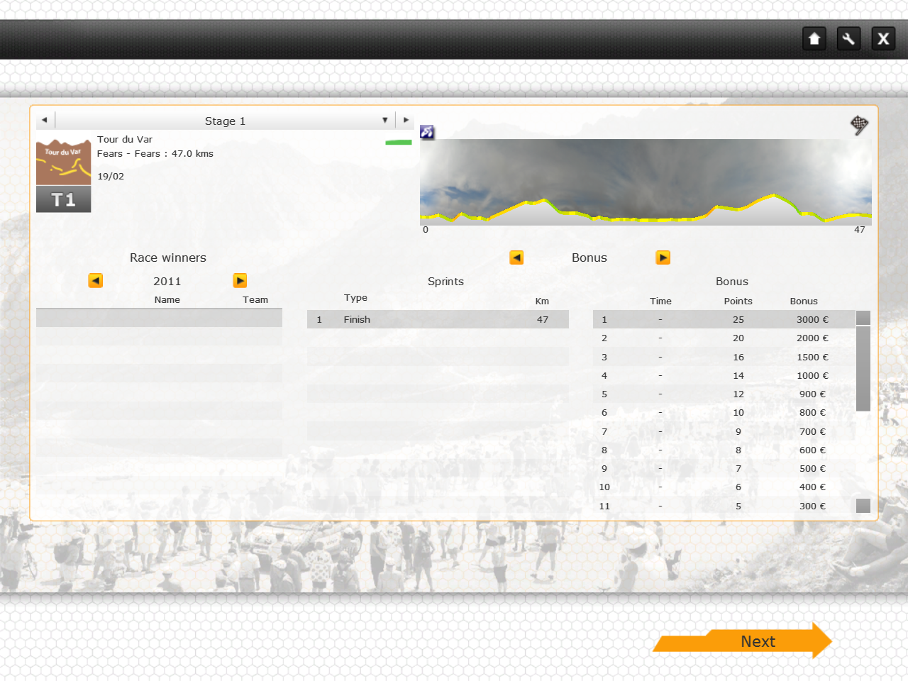

Ian Butler
Stage profile from the TT in attachement.

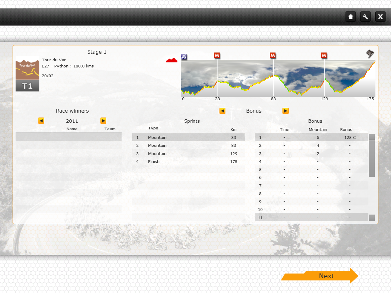

Ian Butler
Stage profile for Mountain Stage in attachement
btw there's got to be an easier way to upload more screenshots in one post?
Ian Butler attached the following image:
lluuiiggii
I don't think it's easier, but the only way to upload more than one screen in a post is uploading them to a host site (like photobucket or imageshack) and using the image code to paste the direct link of the picture, like this:
[img]image direct url[/img]
Pellizotti2
To be a first try, I think you did a good job with the slopes. In most other first stages I've seen, the profile has been completely uneven, with steep, short climbs and similar descents all the time, even though it should be flat.
Therefore I think you've got potential to create some quality stages. Smile
Edited by Pellizotti2 on 01-06-2012 07:33
