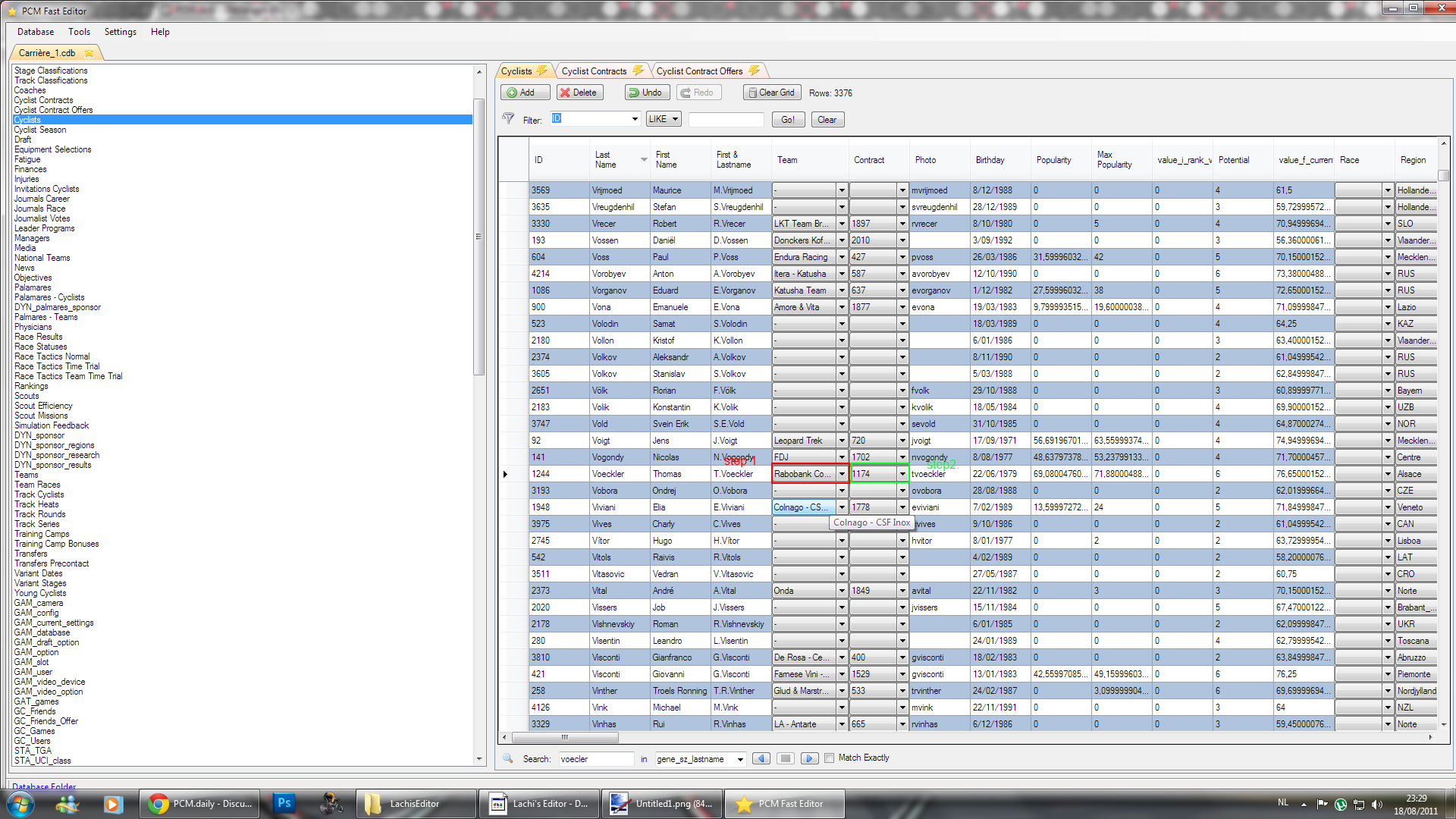

Go to your rider you want => change his team in (shown in step 1.) memorize the number shown in green (step2) and go to cyclist contract
Search for the number you memorized from step 2. and search that numer in the ID column. and change the team also.
joerre attached the following image:
Edited by joerre on 18-08-2011 22:34

Sorry, I don't quite understand. How did you take a screenshot of your editor? I can do the same and show you what mine looks like. |
| joerre |
Posted on 18-08-2011 22:41
Free Agent
Posts: 142
Joined: 19-06-2009
i took a prtscreen and just paisted in paint  |
