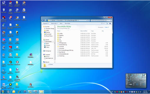

yeathe game works fine.. hey how do i attach an image??
Edit: The image is attached
if its not clear enough then here are all the files
Config
Database
Editor
Gui
Users
DXDiagLog.log
GameCenter.log
Local.cdb
Local.cdb~
Pro Cycling Manager 2011.log
Read Me!.txt
UnHandledData.dat
Variant.log
Edited by mattie524 on 17-08-2011 07:42
| mattie524 |
Posted on 17-08-2011 10:01
Domestique
Posts: 564
Joined: 15-07-2011
PCM$: 500.00
those are the only files i have in the Pro Cycling Manager 11 game.. i dont have any other files/folders.. |
| joerre |
Posted on 17-08-2011 10:18
Free Agent
Posts: 142
Joined: 19-06-2009
you are looking in my documents folder... you need to look at your C:/ drive Programme Files or Programme Files (x86) if you have a 64 bit windows. en their you finde the cyanide folder |

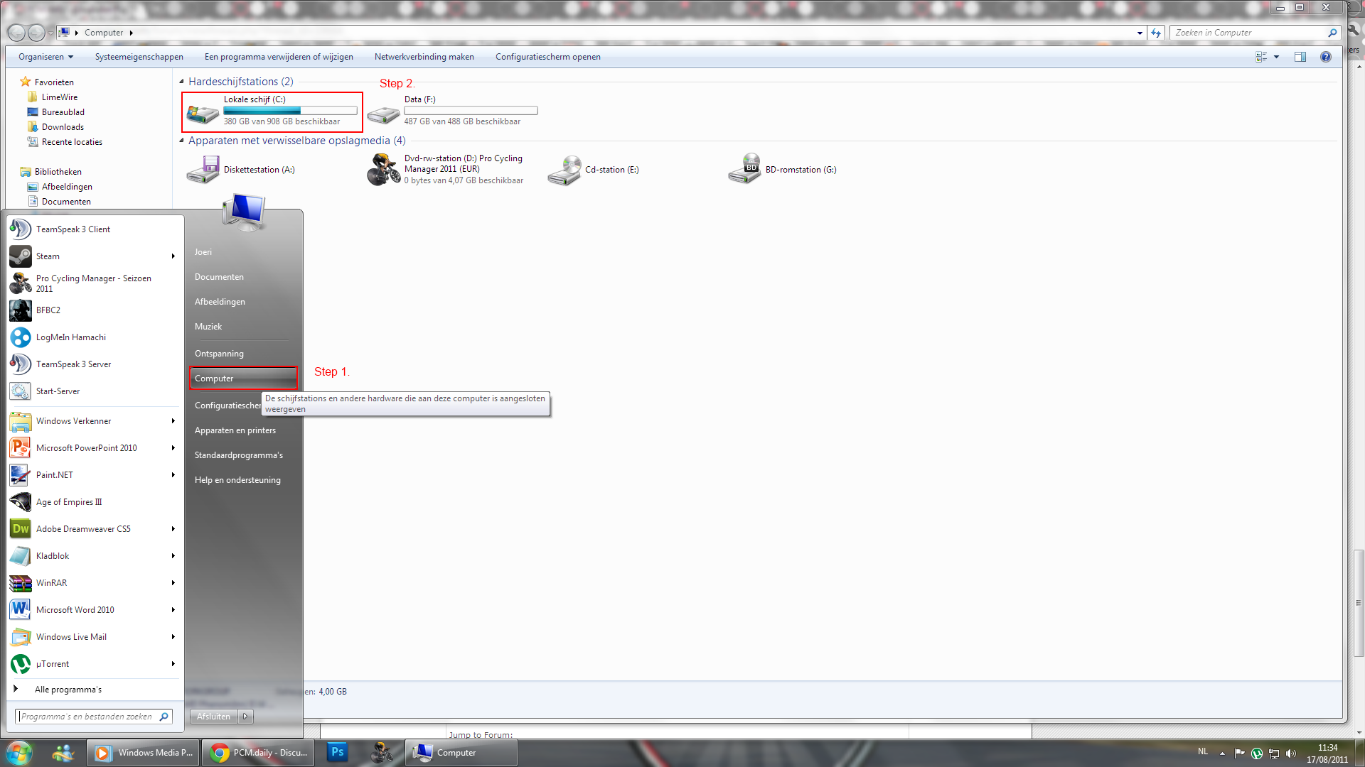

| joerre |
Posted on 17-08-2011 10:37
Free Agent
Posts: 142
Joined: 19-06-2009
Click on my computer ... C:/ Drive ?!
joerre attached the following image:
Edited by joerre on 17-08-2011 10:38
| mattie524 |
Posted on 17-08-2011 10:48
Domestique
Posts: 564
Joined: 15-07-2011
PCM$: 500.00
ohh i found it! sorry i realised i was looking for a pro cycling manager folder!! its in cyanide!! thank you sooo much!! both of you! you are soo much help
