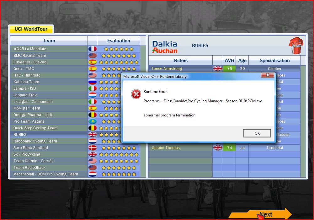

Hi
When I try to play a season with the team I edited on the DB editor a runtime error comes up saying abnormal program termination
shraggi attached the following image:

If you attach your database, I will have a look.

Well, you didn't fill a whole lot of columns in DYN_team, e.g. fkIDdivision, jersey_sz_abbreviation, fkIDteam_type and fkIDcalendar1 and fkIDcalendar2. If you fill out those (use PCM Fast Editor, Lachi's Editor, Full Editor or similar), I'm guessing it will work.

No, that wasn't the team I was using, I was using team ID 59
Anyway it seems the error comes actually when I added the race I edited (called tour de green walk) as it is considered 0 days. So it's fine but thanks anyway
