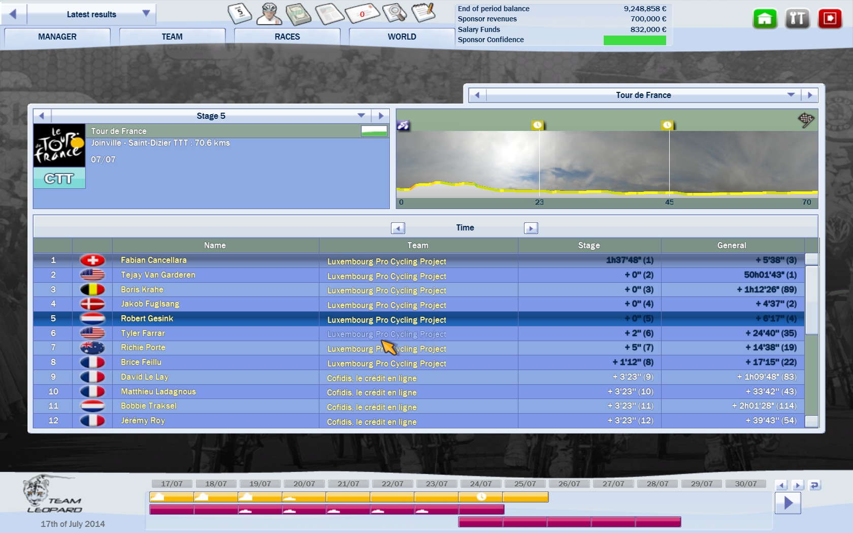

I typically pause once my team is on the line, then based on skills adjust the time... Cancellara gets a 0:25 pull most other good TT riders will get a 0:15-0:20 pull and the weak riders will get a 0:05-0:10 pull. Then you adjust the effort slider to the length and profile of the course and unpause the game... If the race starts with a climb and the front rider is a good climber, I'll make his first pull 0:15-0:20 regardless of his TT skills so he can pull the train up the hill to get the team rolling for the TT guys to start doing damage.

3rd. Since you want to talk results... The last time I ran the 70 TdF TTT, I beat the next closest team by over three minutes, put over five minutes into Contador, and came out of Stage 5 with 1st, 2nd, 3rd, & 4th overall and a total of 6:26 over Contador in 5th. I also only really dropped two of my riders along the way, though two more were coming apart in the last k... I will say it's 2014 on my game so AC has probably aged a bit and he's riding for a sprint heavy Katusha squad so he got a bit screwed on the team effort but, just the same, Tejay will be thanking that TTT for his first maillot jaune in about 10 days.
dueceone attached the following image:
