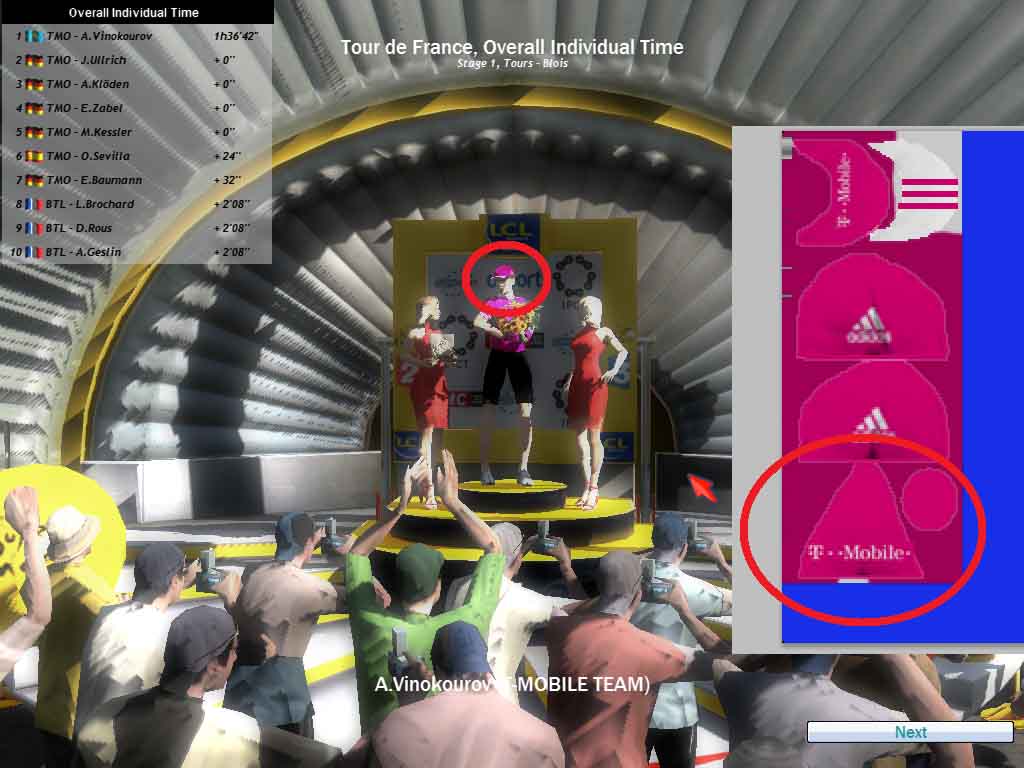

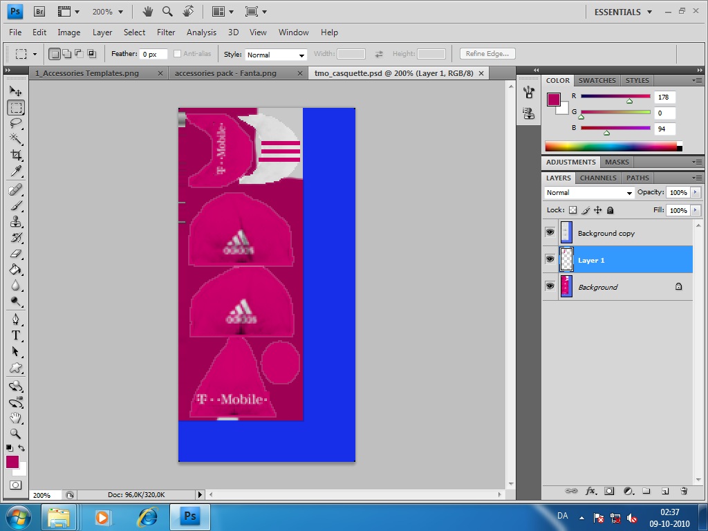

hmm - Gave the casquettes another chance. Still can't figure the front out. How do you add a logo to the front? I followed your template and the front was blank in-game
attached a SS of my casquette in CS4.

@thanks for your reply. I hope this can help you understand the issue.
as you can see the casquette is in fact working. The front with the T-Mobile logo is another story though.
The tga file can be found here
https://rapidshare...quette.tga
it's very weird

I'd say it works - you just can't see it at that distance. You could also move the logo up a little / try to make it sharper.
Could be wrong though - testing with this should clear it up.

well - just tested your casquette with the black area. No effect whatsoever - that whole part of the tga file doesn't seem to appear in-game as shown below.
https://img831.ima...ia=mupload
It all seems very weird too me

As you say - it's bizarre. The cap you've made is done correctly. I stuck the big smudge of black on it as not being able to see it was the only thing I could think of.
Cap is created as it should be -
Never noticed - but do any of the other caps work as they should? Compared it to the Liquigas cap and is exactly the same. If that works, can't see why this wouldn't.  |
I'm afraid this issue apply to all caps made for PCM
a few months ago I went through the whole process of figuring out how the caps work and to be honest I still don't get it. It seems though only the middle part of the casquette and the flip at the top is visible in-game
Edited by T-Photon on 09-10-2010 13:05
