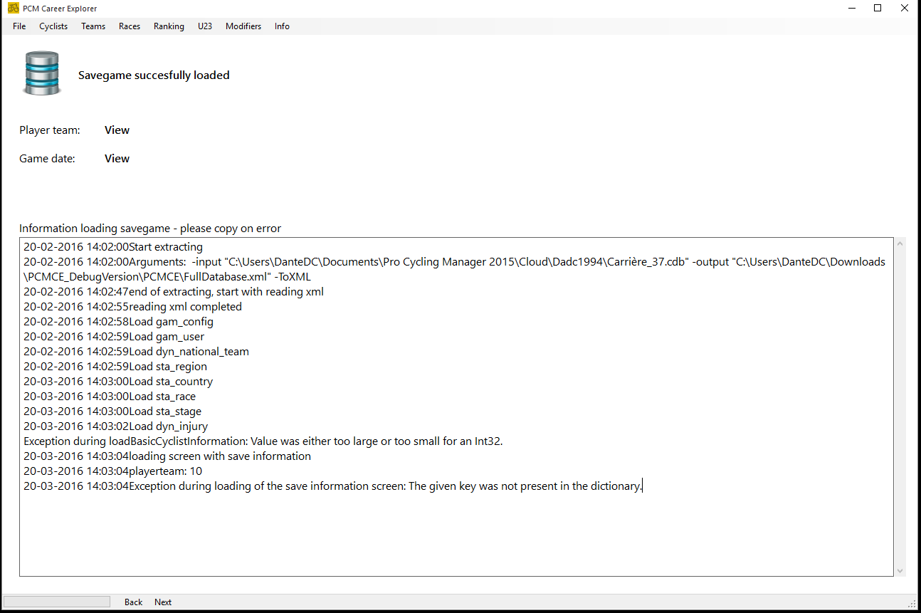

is there someone with the issue that can try following version, copy me the debug information after the save is loaded, and also attach the savegame?
https://davydepuyd...ersion.zip
please copy this after loading:

Ok, thank you, this is very helpfull.
The reason some people are having the issue is the decimal seperator is computer dependant "." vs ",". I will update the code so it works for both  |

Ok, can you try following version? if all is ok, when the savegame is loaded the name of your team and the current date should be filled in where you had just "VIEW" in your previous screenshot
https://davydepuyd...Debug2.zip |
It works now thanks! |

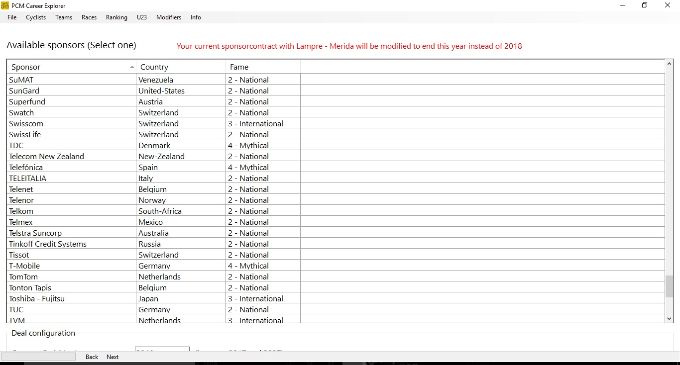

Is there any way to scroll down to the bottom part? I can only scroll through the list, but not the "frame".
I will update the code, it's a issue with resizing on smaller resolutions then i've tested with |
