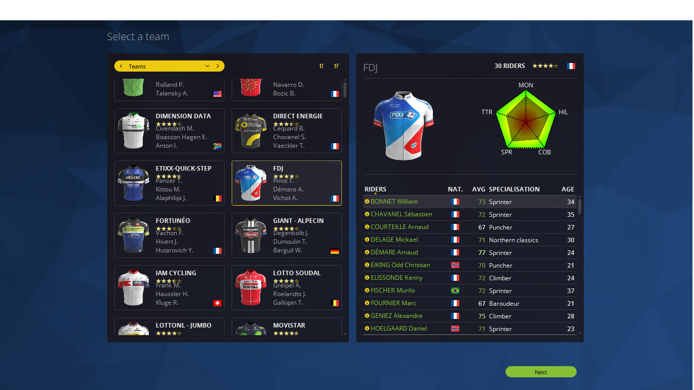

Dura1
When I open races only some races are 2017 edition and there are all teams from 2016, can anybody help me, pls
matt17br
Not all races have 2017 routes, we're not superhumans and it's impossible to have all races with updated routes - most races haven't even released their new routes, and for most of them, finding accurate data is a pain in the ass too.
As for the 2016 teams, could you explain what you mean or take a few screenshots of the situation?

Dura1
Dura1 wrote:
All teams are from 2016 season screenshot wont send

matt17br
Dura1 wrote:
Dura1 wrote:
Attach the screenshot by quoting my post and clicking on "Browse..." Smile
http://v.ht/Matt17

Dura1
Dura1 attached the following image:
matt17br
...what db have you picked when starting that career/one-off race?
http://v.ht/Matt17
Dura1
2017 DB

Dura1
ruben wrote:
No you don't. Because then you don't get all the fake names.
You've selected the wrong DB when starting.
But then it opens me a one box and I click OK and nothing happens
ruben
You've not installed the my documents part, that's fore sure.
matt17br
Nah, he just doesn't have the game 'from steam' and therefore doesn't have the first official patch installed.
Please read the FAQ.
