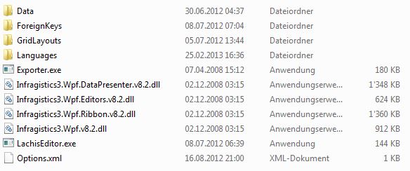

Just can't get rid of this problem Lachi, maybe you can tell me how to solve this error.
| Lachi |
Posted on 29-05-2013 23:35
Posts: 8360
Joined: 29-06-2007
I don't see anything. Why don't you just attach the picture to your post?
And if you got an error, then there should be a file called Error.txt. Please copy the content from that file to your post too. |

No need to quote your post, I don't see the image.
But according to the error a folder is missing.
Make to sure to extract the archive correctly which means including the subfolders.
If you can't do that, then create the folders yourself. It should look like this:
Edited by Lachi on 29-05-2013 23:53
The problem was that he didn“t "create" and/or extracted those 2 subfolders (the Data and GridLayouts) correctly after extracting the archive. The subfolders aren't in the archive either. But by the way after I made the GridLayouts map the problem got solved. Thanks. |
