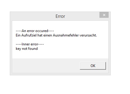

Yes I know how it works and now, after downgrading windows on an old version it also works again like it should. Same Save and same layout
I tried it with many different saves, but it only works after downgrading windows.. |

Hello i have problem. I need edit my PRO CYCLIST but 1 day and day when season end 24/10-31/12? i cant edit my savegame always error but 2/1-23/10 all is OK. i need change riders who end carrer or they have no contract ( for exemple ewan caleb no contract and i need change it) bur i cant do it because when season end i cant open my savegame only when i start new season and its too late :/
----An error occured----
Exception has been thrown by the target of an invocation
----Inner error----
key not found
this error i have only with this new version |
| matt17br |
Posted on 14-08-2017 10:34
Directeur Sportif
Posts: 10519
Joined: 28-09-2013
----Inner error----
key not found
Lachi might have an easier time troubleshooting this is you attach the weeklysave that works and the current savegame that doesn't even load.
----Inner error----
key not found
Please try the new version, maybe you had the same problem as Rossignol. If not, please attach the save you cannot load. |

Lachi wrote:
----Inner error----
key not found
Thx all is fine now  |
