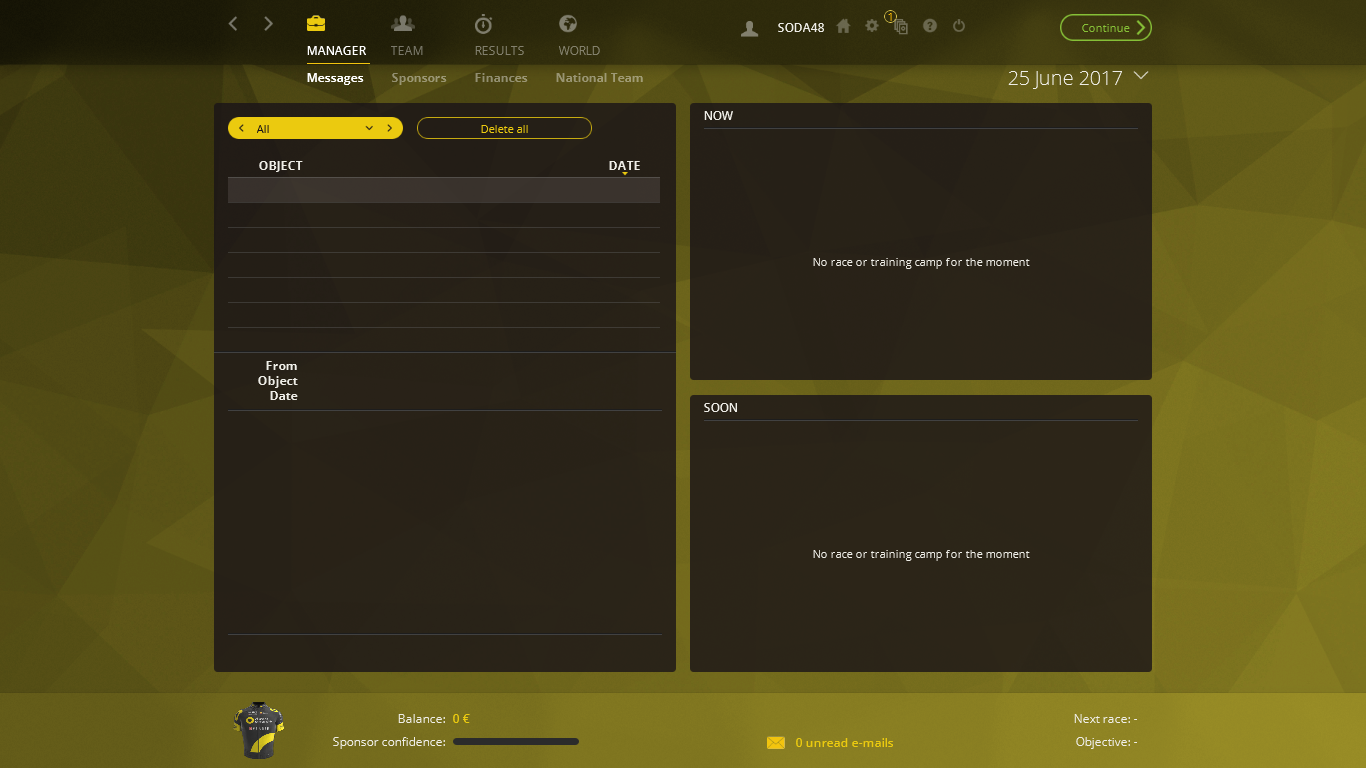

I've done everything according to your suggestions and partially works. At least with some teams. With FDJ for example it works. But when I play it with Direct Energie (the team where I put Jonas Ahlstrand in my version of the db) it transfers me to some sort of weird career interface (see image). Any idea why?

matt17br
Could you attach your db again?
http://v.ht/Matt17
The dj 12
Here you go
The dj 12 attached the following file:
officialrelease_20.cdb [403.94kB / 329 Downloads]
matt17br
...you still haven't added any ids in firststage and laststage in STA_Race. Also choose a different CONSTANT in sta_race, not ideal for it to be the same as the Danish Championships. Call it champ_sweden and champitt_sweden or something.
http://v.ht/Matt17
The dj 12
I have fixed the first stage and last stage ID:s and changed the CONSTANT. But still the same problem. Is there anyt tables besides STA_race and STA_stage that you should edit if you want to make a race?
The dj 12
Could it be because I haven't contracted the riders properly?
matt17br
Just noticed that you used the same filenames in gene_sz_filename in sta_race as the races you're using the files of. How about you change those to nat-swd and natitt-swd and make a copy of the files you've used before calling them in the same way?
http://v.ht/Matt17
The dj 12
Copy the files in CM_Stages and change the names of the copied versions to nat-swd and natitt-swd?
matt17br
nat-swd_2015.zces/cds
natitt-swd_2015.zces/cds
something like that
http://v.ht/Matt17
The dj 12
It's working now! Thank you guys so much!
