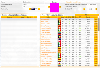

what the hell? thWhen i go to choose the jersey it just has a pink square (in the custom team setup in career mode) and then in the career mode there is a aqua square in the bottom left corner and all the dates are out of place..
when i go into a race my jersey works perfectly which im excited about but otherwise im kinda dissapointed..
not your fault tho but do u know how to get it back to normal??
ill try attach both screenshots in another post.. :/

this is the first one.. if i can get it on here. its the pink jersey square

ahhh the good ol' pink squares. they have been raised numerous times throughout this forum and unfortunately cant point you directly where to go to in this forum off the top of my head. although in saying that, im not sure the pink squares that are normally referred to in this forum are related to yours
do you have the capabilities to upload what files you are trying to insrt in the game? custom jersey files...did you download the files from this forum?
to start with...id replace what you have added with the original cyanide files. then check the cyanide jerseys all display correctly. then from there, if you show us the files you are trying to incorporate, we can go from there

the files simply musn't be added correctly to the files. that...or the files arent correct in size and formatting etc. maybe even naming. hence my post above

yep that will be it. the transfert files must go in the 3D/Cyclists/Cloth/Team then whatever custom (cXX) folder you are using. they go in there along with the maillot and whatever other accessories you have
i know jdog's files very well so i know you would have got one folder, with a Gui folder within and also loose tga files (maillot, accessories, transfert files). all these loose ones go in the file i just stated above in this post
the Gui sub-folder open up and you will find two more sub-folders which will be "team" and "team shirt". so go into your "team" folder and you will find the logo and minilogo. you then go into Cyanide/PCM11/Gui/Team and overwrite the current custom files for both "logo" and "minilogo". for example - if you are using folder "c00" for your files, then rename the logo "c00" and paste over the existing one. also rename the minilogo "c00_minilogo" so it is the same name as the existing one...and paste over original file
for the team shirt (.dds file) - this is done in Cyanide/PCM11/Gui/Team shirt and rename your file to the same naming so C00_minimaillot and paste over original file
hope this helps mate. i can prob simplify it a bit more by using steps in numbered format but give it a crack first. just remember one to backup your original files (which i think you have), two place the files in the correct folders as i state here and three rename your files so they coincide with the folder you are using (eg c00)
good luck!
