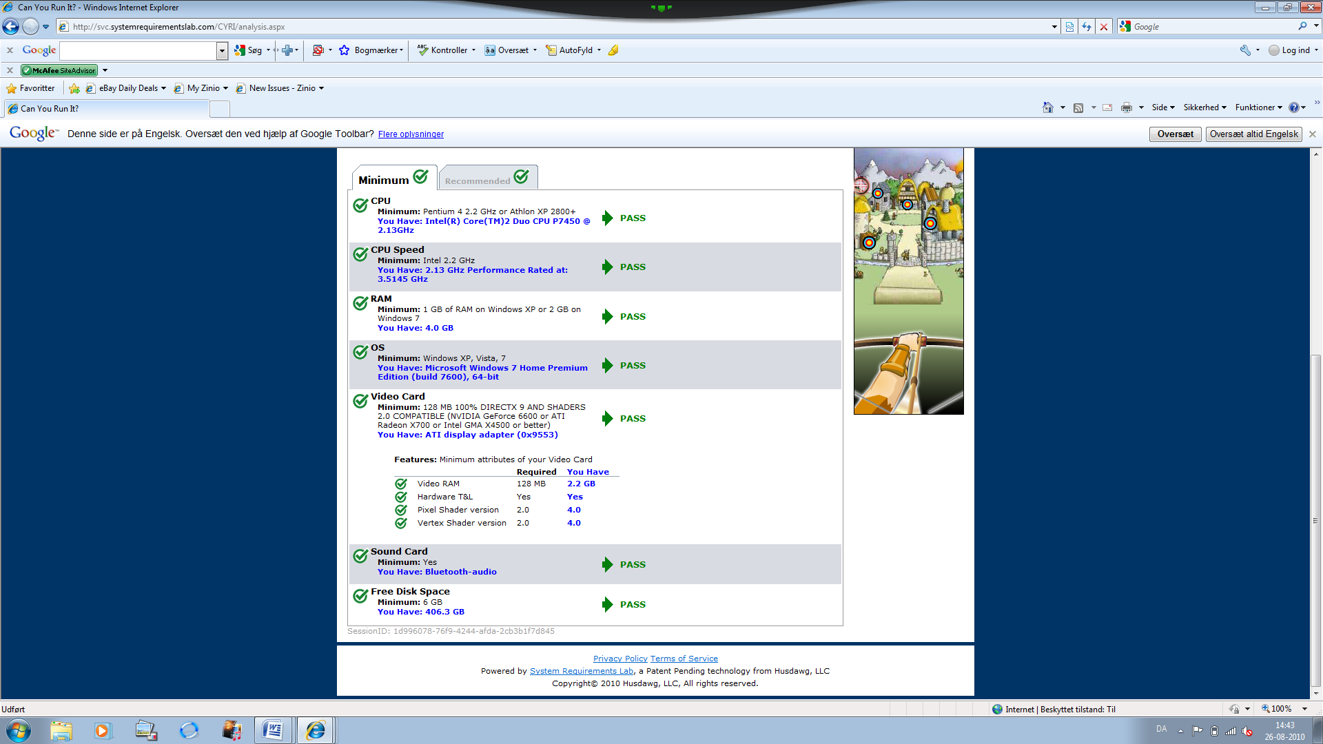

Do you play with a computer or laptop?
Do you have a wide monitor?
Cyanide has this Technical FAQ which you should read: https://www.cyanid...amp;t=3191
But ultimately we need to know your computer specs to help you any further. So use this link again https://svc.system...lysis.aspx and then tell us what YOU see. You can make a picture or write it down, but don't send the link again because it is blank.

I'll try and play it on a laptop with wide screen. How do get a picture into |

There should be a print screen button on your keyboard. Press it, then open paint, then save it to your desktop, then reply to my message (using the reply button not the quick reply), then select the picture.
If you run Windows Vista or 7 there should be a Snipping Tool which makes it even easier to capture a picture from the screen.
But if you play with a wide screen then this might be your problem. The game does not like wide screens but you can fix it by either changing the screen resolution of your monitor or editing the config file of the game.
If you don't know how to set the resolution if your monitor google for it.
The instructions how to set the config so that you can play the game in its best resolution can be found in this forum. You might get lucky using the search function. |
lodahl attached the following image:

Your computer specs look ok. So, as I said before, change either display setting. |
