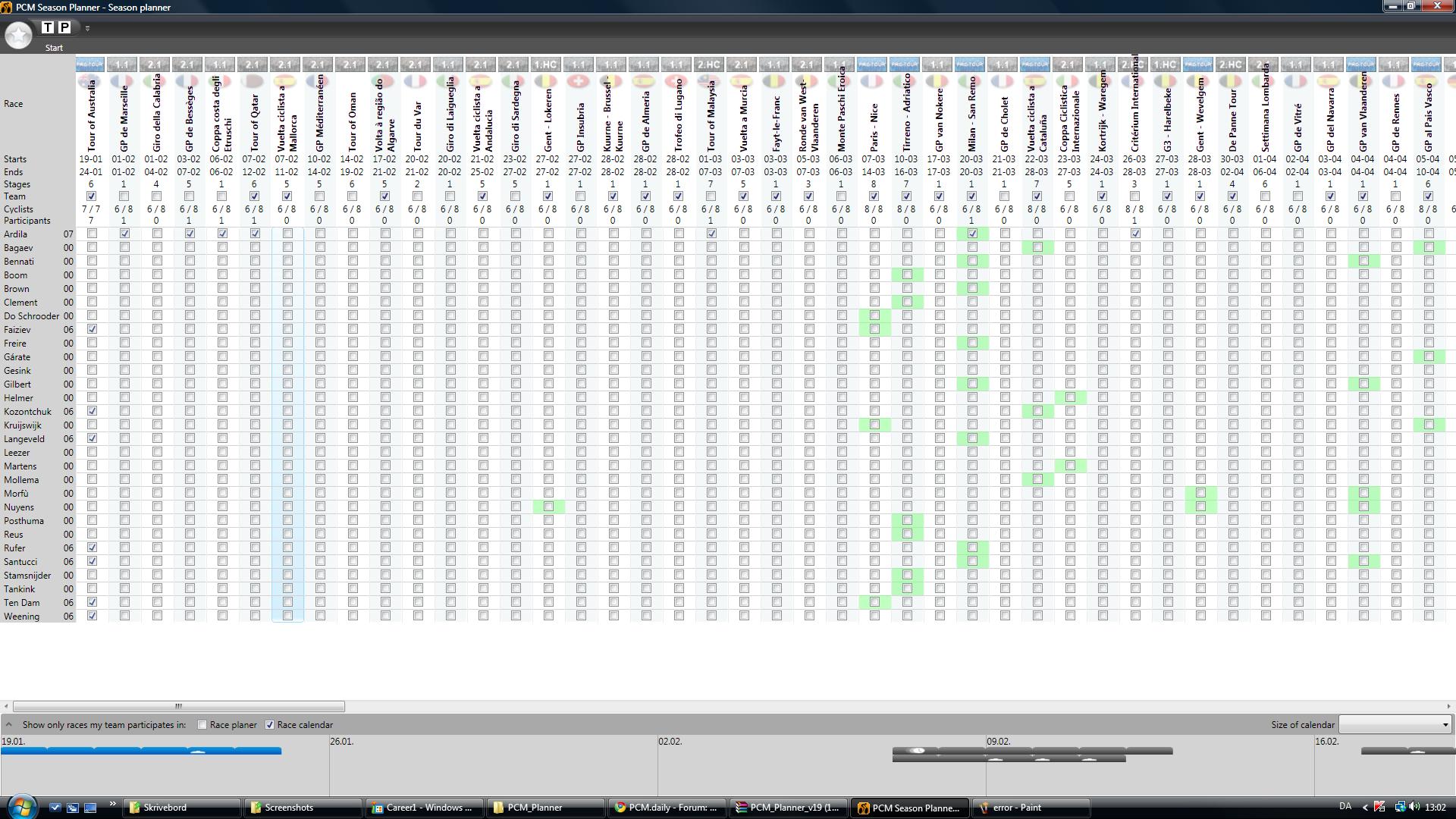

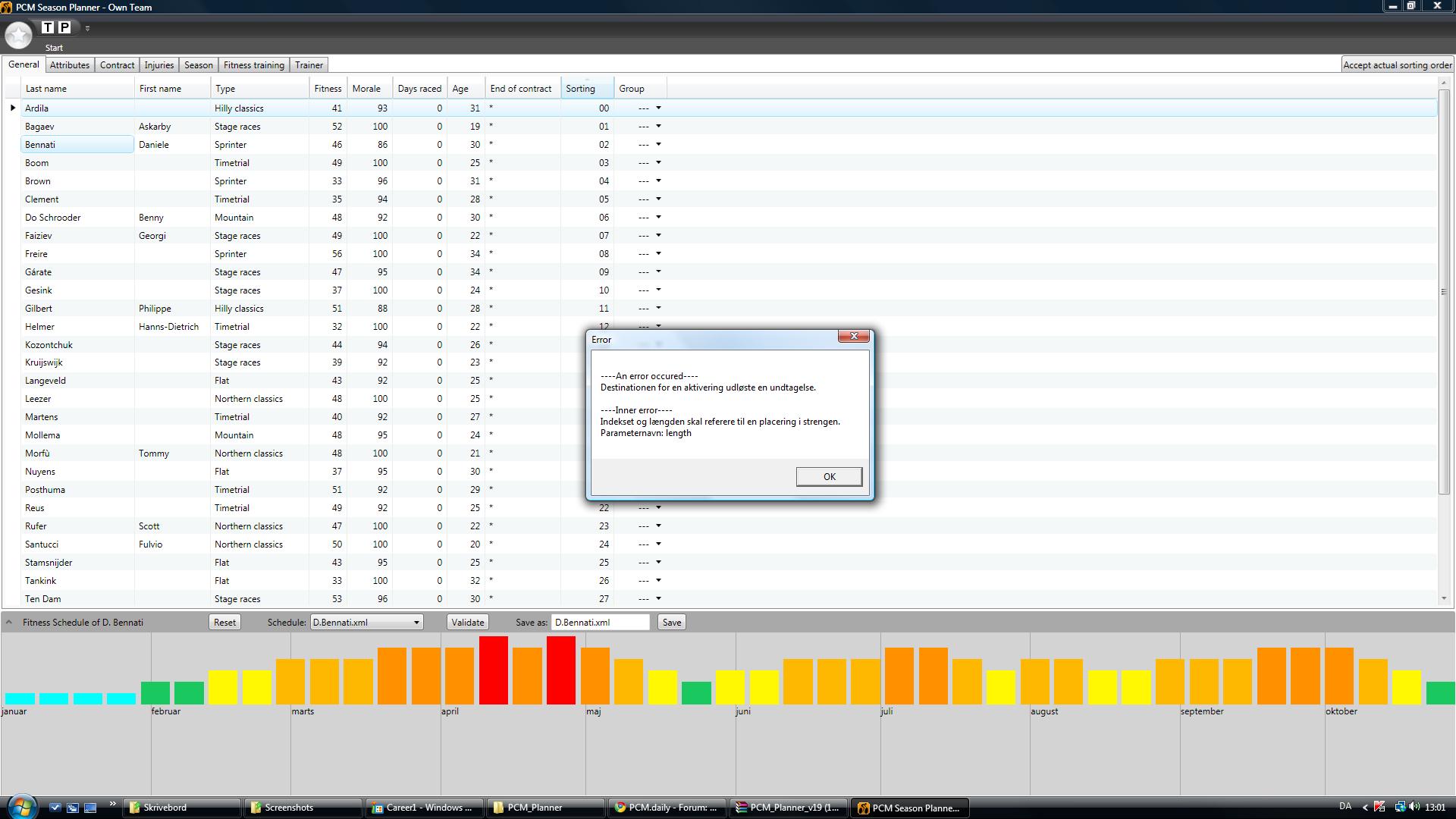

I Got at problem in the planner, when i reach the second season and have to make a new plan.
In the planner, after i have planned the season for each rider, and have to change the fitness schedule, the planner crashes. But only when i select my "old" riders. When i select the new riders i can change there fitness schedules whit no problem.
And as you can see in the pictures the Planned racedays is not transfered to the " My team interface" (Only for riders from the past season, whit newcommers theres no problems)
I have tryed the following:
Deleted the PCM Planner and reinstalled it.
Tryed to change the fitness schedules befor i planned the season
Pushed the botten "Bugfix fitness program" Befor and after trying to change the fitness schedules. Dit not work.
Deleted the old fitness schedules.
Im playing whit patch 1.0.3.0
Btw. Befor the planner crashes i get a error messege in danish. Something about and error in Parametername: Length
hyenen2 attached the following image:
Edited by hyenen2 on 21-08-2010 19:03
| hyenen2 |
Posted on 21-08-2010 12:06
Posts: 23
Joined: 15-07-2010
And another one.
And i found this error file in the PCM_Planner folder
----An error occured----
Destinationen for en aktivering udløste en undtagelse. ---
----Inner error----
Indekset og længden skal referere til en placering i strengen.
Parameternavn: length
----Stacktrace----
ved System.String.InternalSubStringWithChecks(Int32 startIndex, Int32 length, Boolean fAlwaysCopy)
ved PCM_SeasonPlaner.Pages.OwnTeam.xdgOwnTeam_RecordActivated(Object sender, RecordActivatedEventArgs e)
Edited by hyenen2 on 21-08-2010 14:18

hyenen2 wrote:
And as you can see in the pictures the Planned racedays is not transfered to the " My team interface" (Only for riders from the past season, whit newcommers theres no problems) I cannot see it, but if I look at the second picture I see that you did not select the races but only the participation. The tool only counts race days if you participate in a race where your team participates. (should by logical) |
| Lachi |
Which version of my tool do you use?
The button "Bugfix fitness program" is for an older version, but that is written in the manual.
I need you save to check it. |

Lachi wrote:
oops thats my bad, just quickly selected some races to prove my point, it dit not go that well apparently, hehe
Anyhow it is the races im participateing in there is not transferet to the "My team interface" But it only happens whit riders i have from the past season.
And it is only when i select one of my riders from the past season in the "My team interface" i get the error. |
Im using 1.9 and i dit try 1.8 same problem. maybe the error is in the save?!?
Anyhow here it is
EDIT: BTW I can plan the racedays and races i participating whit no problem and i can export it whit no problem to a new save. the problem is only in the "My team interface"
hyenen2 attached the following file:
Edited by hyenen2 on 22-08-2010 18:25
| Lachi |
Posted on 23-08-2010 18:26
Posts: 8360
Joined: 29-06-2007
hyenen2: Could you please tell my why you deleted the prenames of your riders and more importantely, why haven't you told me such an important fact.
