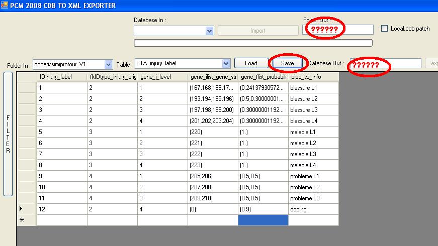

ok, I tried to do what you said. I downloaded the editor and opened it, finding this situation, but than I don't understand where I've to edit fkIDtype_injury_origin to 2, because there are a lot of blocks (that I show you in blue in this picture) and I don't know which do you mean...

I mean, which is the ID of "sospended by UCI" injury? |

I'm sorry for the bad explanation - it was how I remembered it. I've checked now:
You don't need to edit anything in STA_injury. In STA_injury_label, you need to find IDinjury_label -> 12 (the last one). In this line, change fkIDtype_injury_origin to 2 and gene_flist_probability to e.g. 0.2 (you decide this yourself - the higher number, the higher chance of getting caught). |

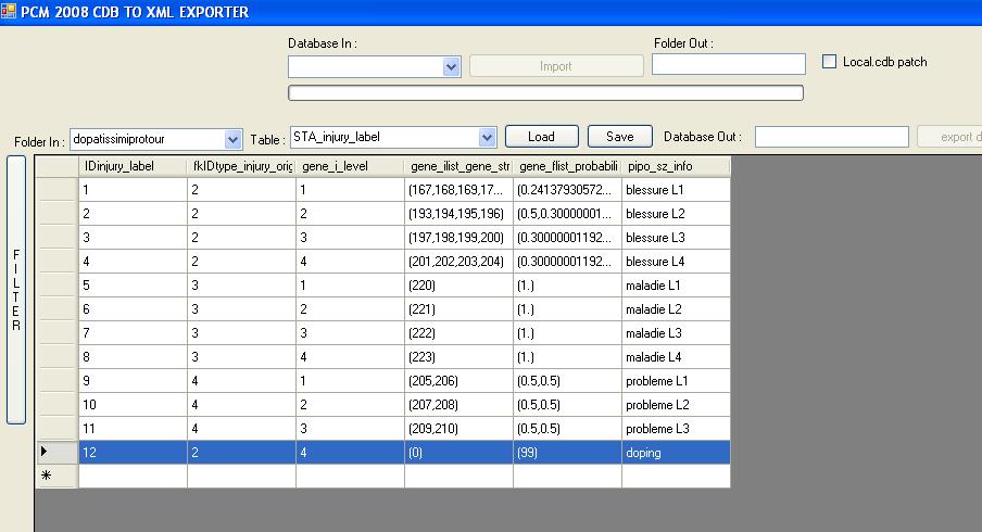

well, I tried to put the level at 0,4, 0,9, even at 99, but in almost 6 months I never found a doped rider. What does it wrong?

Did you check the injury section? There won't be any news update regarding it. |

Yes, I tried to simulate a full season, checking the injury section each two weeks, but nothing: a lot of broken legs and flues, but any doping case |

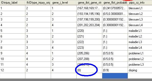

I think my problem is that, once I've edit the injury_label as you told me, then I don't know how to make it effective. What have I to do with the blocks I show you in red in this picture?

In Database Out, give your DB a name and click Export. In the Full Editor folder, open Database and move the newly created DB to My Docs/PCM. In the game, make sure to select it in Options -> Database. |

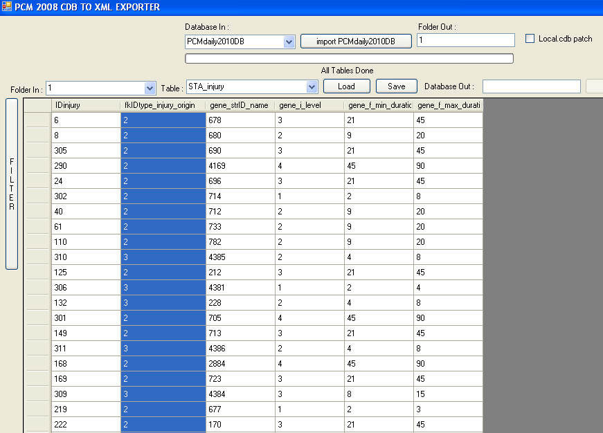

nothing: no way to have doped ones. look at the block in the blue circle: maybe I need to put another number instead of 0?

Sorry, my fault again.
ID 312 in STA_injury, change fkIDtype_injury_origin to 2. |
