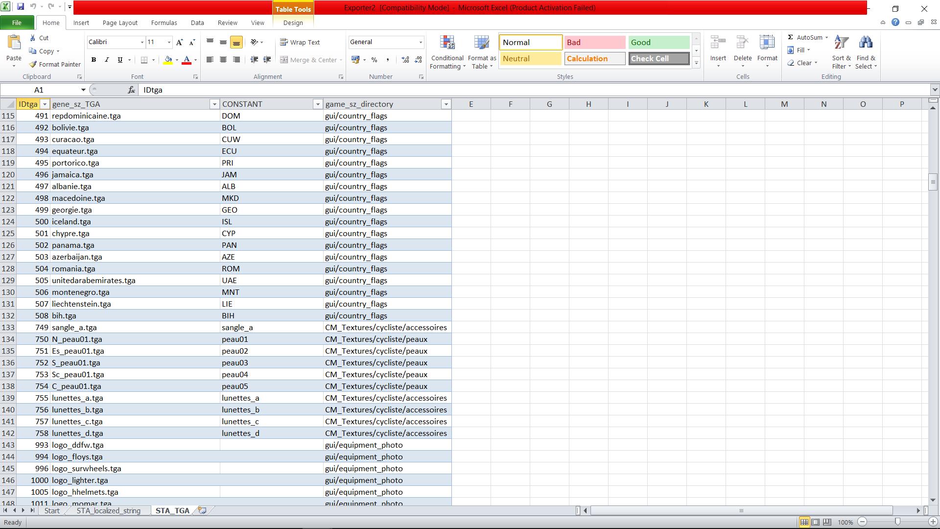

Now, I've another problem that has already happened in the past.
Context:
I added 6 nations to the DB. All seem to be set in the right places but somehow the flags don't appear with the respective riders. This happens in the screen where you have all riders and you can start a customized team. I don't know if this causes the game to crash or not. Also,the flags don't appear with the Dubai Tour and the Abu Dhabi Tour.
I've tried everything and I'm clueless. I'll attach the DB and the local file. The countries that have this problems are the ones starting on 103 to 108.
If anyone could have a look, I'd appreciate it. It's more than welcome.

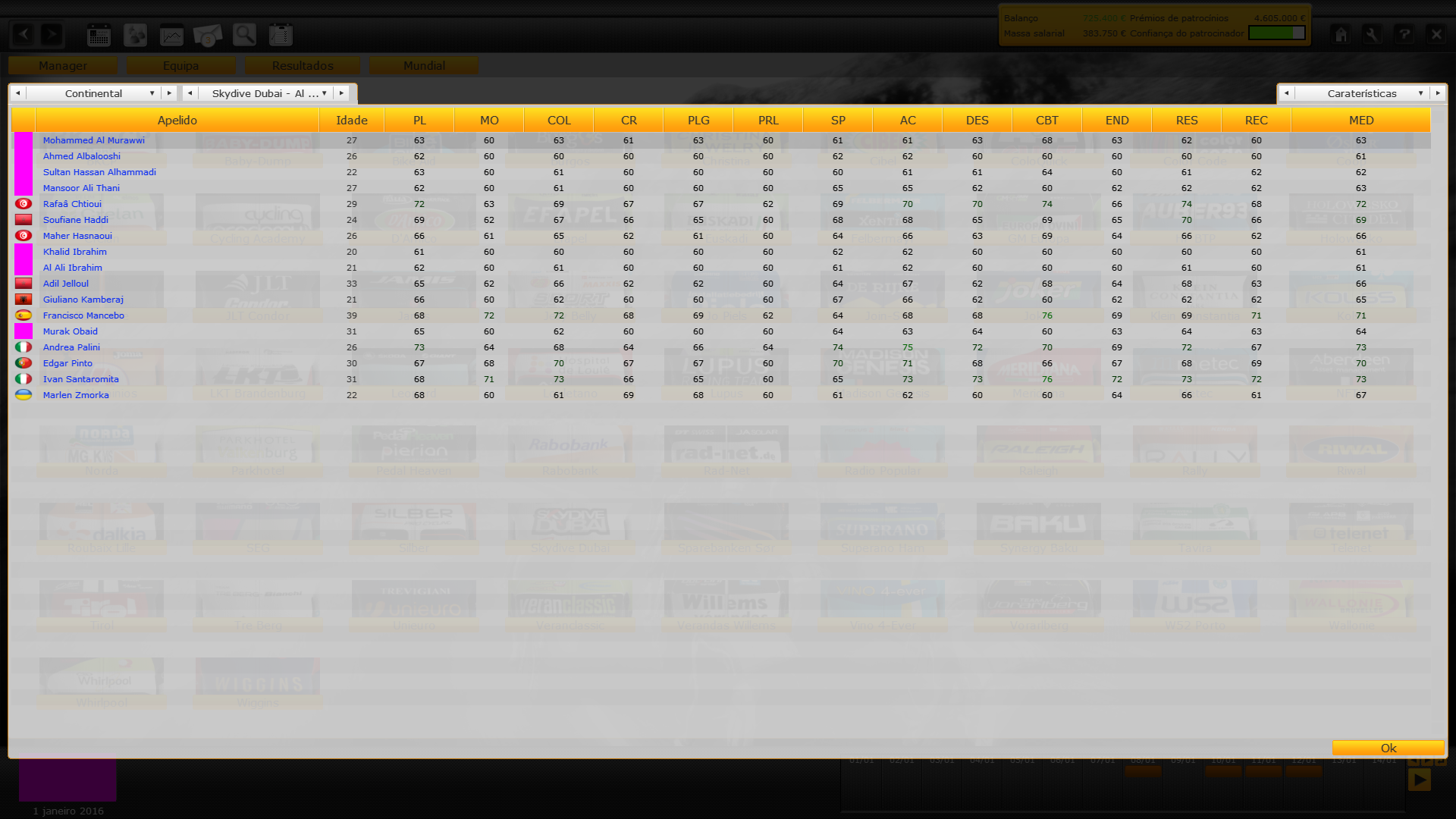

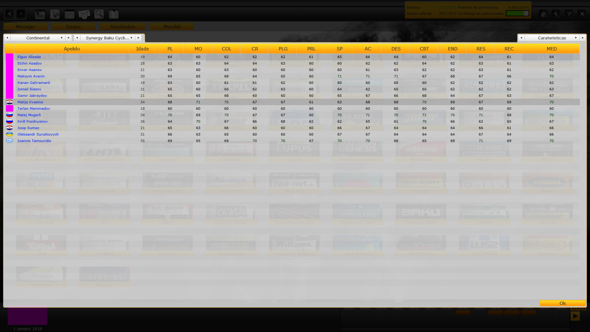

| jnz_1989 |
Posted on 28-01-2017 13:15
Free Agent
Posts: 142
Joined: 03-02-2012
Couple of screenshots.
I can start a career but the pink squares remain there.
I've tried again everything but still the same.
Could someone help me?
jnz_1989 attached the following images:

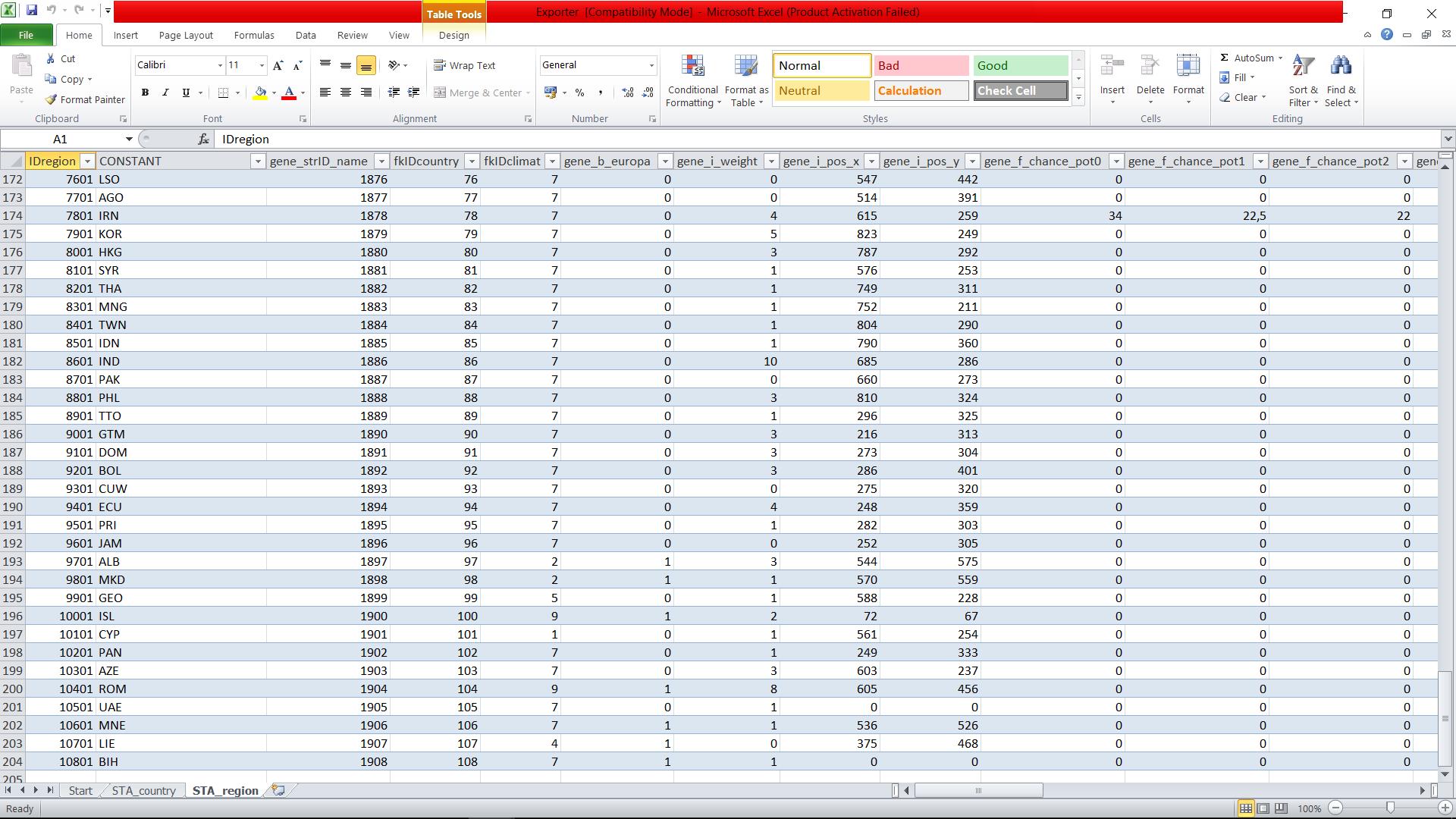

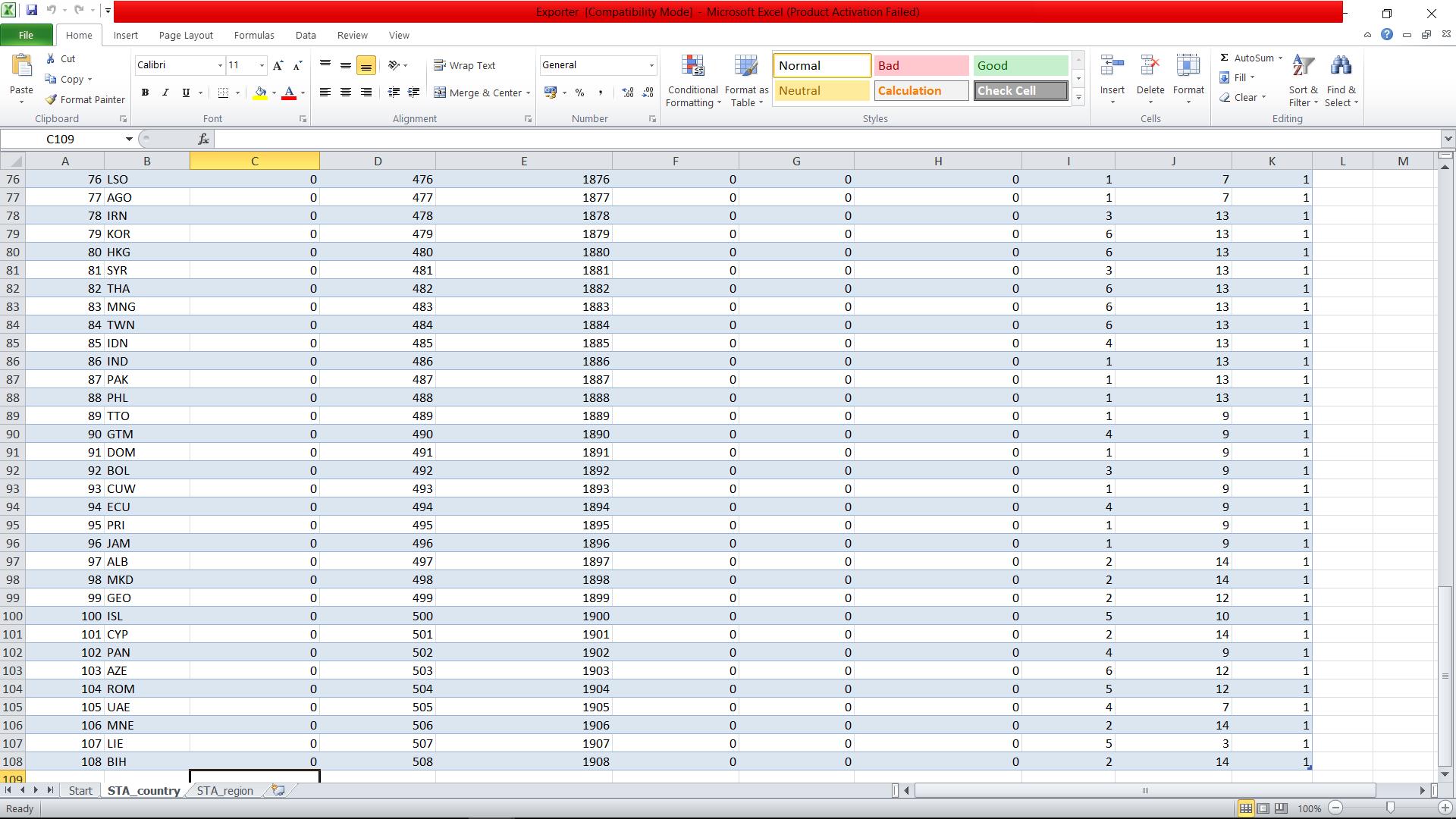

I'm not home until later, could you maybe take a few screens to Sta_country, sta_region, and the tga table in local? As well as maybe sending the files.

| matt17br |
Posted on 28-01-2017 18:03
Directeur Sportif
Posts: 10519
Joined: 28-09-2013
You have used a different constant in local.cdb for Montenegro, can't see any othe problems.
Sorry I wasn't clear but I rushed my answer, as for files I meant the tga flag files you added
Thanks. I've spoted and changed it.
But in that case why are the others with pink squares? It's strange. I'm debating whether I continue and start playing the DB since the game doesn't crash (I'm still finishing other parts) or I continue to look how can I solve this.
Could it be the case that I can't add any more countries?
As for the flags they're correct, I'm sure. I've downloaded them from google but put it similar to the others. I've checked over and over. |
| matt17br |
Posted on 28-01-2017 18:55
Directeur Sportif
Posts: 10519
Joined: 28-09-2013
Send them anyway, the matter might be more technical than you think because they not only need to be tga, but 32 bit tga too
Looking at the db the flags can be the only problem.
| jnz_1989 |
Posted on 28-01-2017 18:58
Free Agent
Posts: 142
Joined: 03-02-2012
Sure, here they go.
What's strange is that, from the moment that I copied the table, others stoped working as well. It was from country 102 to 108. It's very strange because before they were working. For example, United Arab Emirates now have a pink square and before didn't.
