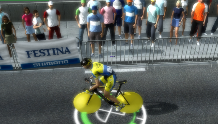

So I don't know why but I can't stand to see the Cyanide equipment, so I tried to make my own.
Well, the let's just say that it didn't go so good.
i.gyazo.com/2daa83d03d884443c323d620fb1f4708.png
(The frames aren't made by myself. It was in one of the databases that i tried)
Making the wheels didn't seem as complicated as making frames, but apprently it is.

At first glance, it looks like your teams Auto-colouring might be set to white and the _s file transparency is solid and not transluscent.

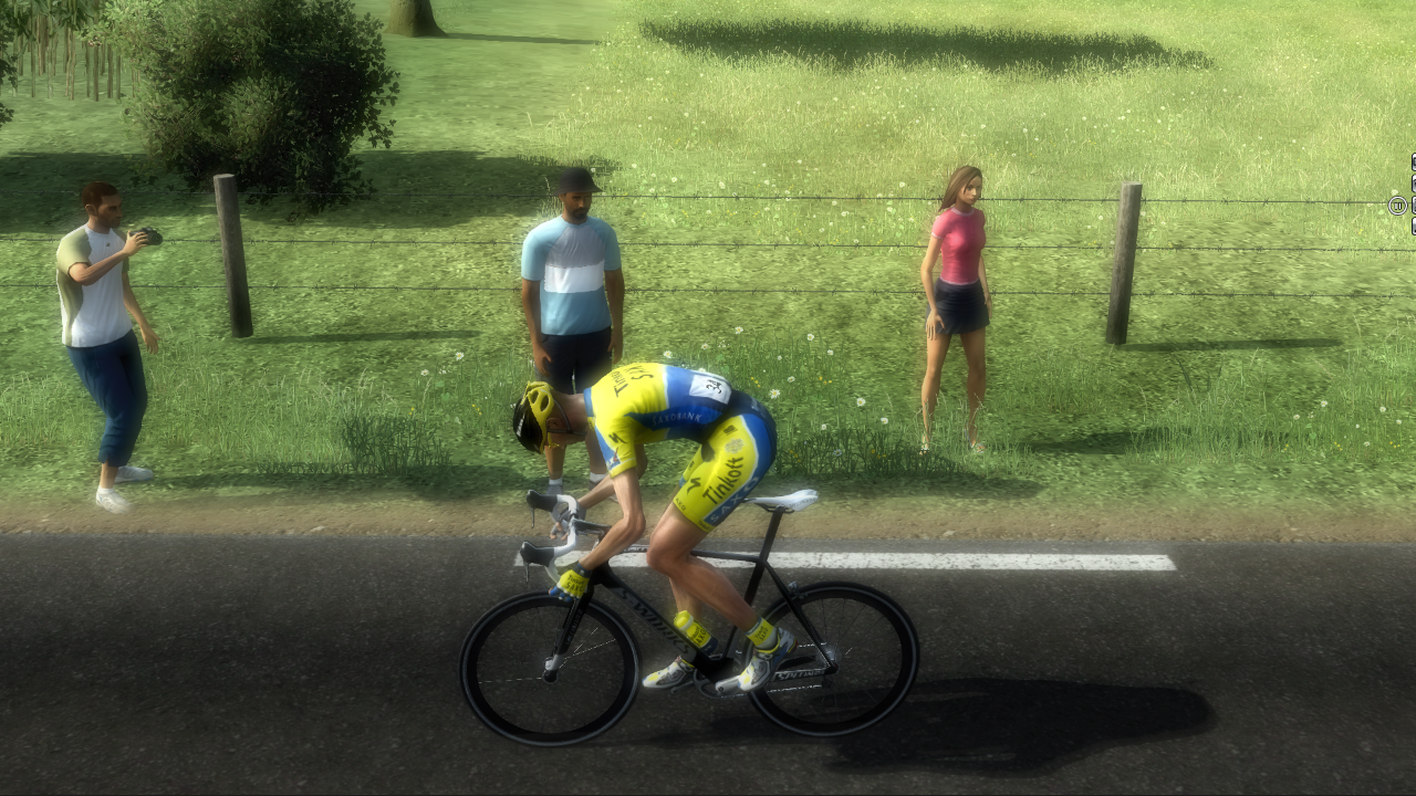

i.gyazo.com/0003d664521e330fa288fee423ef3920.png
i.gyazo.com/b248d3630b20f86d5e2dcd8e46691708.png
lluuiiggii
You can open .nif files in NifSkope. As for the problem in your wheel, with this second screen it is indeed the problem that KenL mentioned - see how the whole wheel gets yellow, that's because yellow is the color of Tinkoff Saxo and the _s file is set to put autocolor color on the whole wheel. To change the autocolor, you need to edit the alpha channel of the _s file (white means that place will be autocolored, black/gray means no autocolor - take a look at some frames/helmets, that should be clear Smile). To fix your problem, either change the autocolor of the _s file of your wheel or, probably easier, copy the _s file of the wheel you've used as 'base' Wink

OK so i tried a few things. I don't know what I did wrong but you guys can properly spot it.
So i tried just taking a wheel from another database a just a H on the left and emmelie on the right side of the wheel. Did touch _s or _n, only the _d.
Same results (also added a Contador bike):
i.gyazo.com/5afa4a42629961c4ea570dc528eb408f.png

I see that you have two layers in the Photoshop screen containing the graphics of the _s and _n file - did you re-save them? If yes, as I said, you need to check the Alpha channel of the _s file Wink In the box of the layers in Photoshop, there's three tabs: on the middle one (Channels) there should be the Alpha Channel (if it isn't there click on the button to create a new layer while in the Channels tab, then it should appear). Try copying/renaming the _s.dds file, not copying it in Photoshop and resaving (I'm assuming that you've done that, if not then the problem might be something else but I still think it's what KenL said Pfft).
KenL
Your _s file has no translucency.
Rename the one I sent you and try it out.

So i downloaded your pack, and didn't touch _n and _s. Added a small change to _d file. Still the same thing, just not a disk but a completely yellow wheel, that look like a normal RR wheel (Tinkoff - Saxo)
