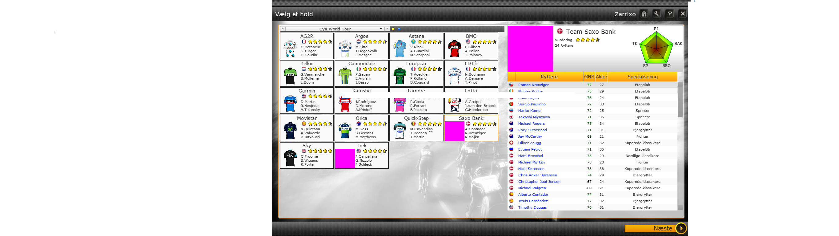

Hello, the shirts ingame at the team selec turned purple only with this DB (roster update 2014), and NOT the expansion pack itself, which works fine.
I have tried everything, installing the DBs again, checking the right folders and such, also read about moving around the local file from the backup, no luck there either, please help. |

Which teams? All of them? Could you post a screen?

Only Saxo bank and trek, = the new teams, and perhaps new shirts? anyway i'm fine with the old shirts just not these purple ones
also ingame it's just some random white shirt. |

hope it's visible

That means that the game can't find the shirt/minishirt files. So I'd check again about the installing directory. Can you post a screen of where you installed the files?
Also do you have the Real Name DB or the Expansion Pack? If it's the latter, did you install these minis and flags by yourself? Because the ones included in the Expansion Pack are different than that
