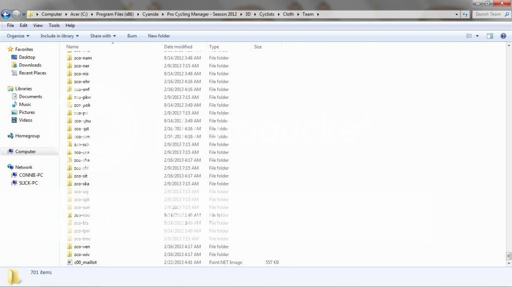

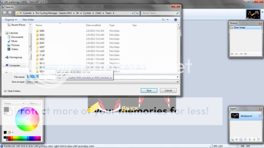

Here is the file type and location the jersey is in. Let me know if you need more info.
This is the file type, and size.
This is the location-Program Files/Cyanide/Pro Cycling Manager 2012/Season/3D/Cyclists/Cloth/Team
I did not however put it in a folder, as you can see from the pic. Hope the pics are clear. They can be opened in any photo program quickly to view.

The shirt should be placed in ...Cloth/Team/c00 Wouldn't it be weird if only your shirt was not placed in any other folder?
